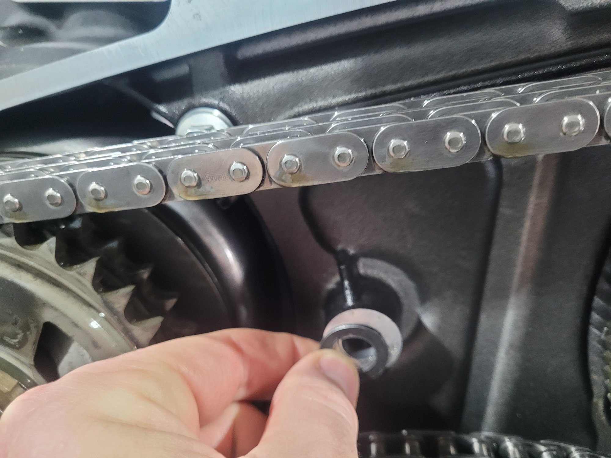

so, let me update this for the few that have swapped to forwards on any bike most likely....
i pulled the outer cover to find the stand gasket for the shaft had shifted slightly...allowing the leak to place.
my idea to create a fix, short of an 800$ case swap (new parts price)...is to take a piece of delrin or teflon round stock and machine it to a .490" dia...then insert through the case enough to stay centered up through the shaft hole, and reinstall the push on cover. this will help keep the gasket centered and not have the new shaft tear up the case finishes.
i really want to machine it for an o-ring, but don't want to fool with pulling the inner cove too.

you have to swap both covers to eliminate the hole, my pic is of the inside inner cover.

that is something i am looking at having done, i want new cases, just dont want blow 800$ for that, and not sure i want scuffed up used ones.
i think for the quick fix, i am going to fab a dowl that i can insert behind the cover, just to keep the gasket from walking again. when i do the 128 buildup, i will get it machined or most likely replace the covers then.
