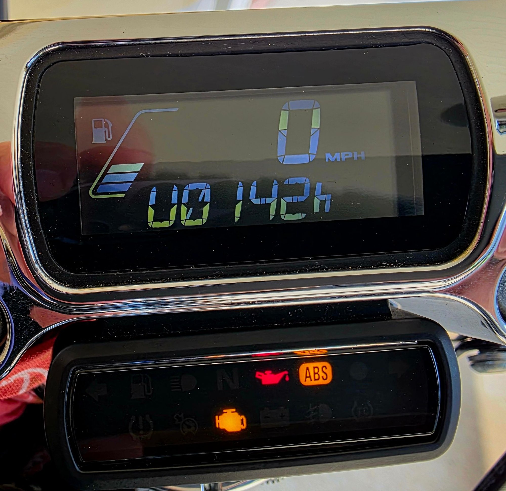

I had to take my 2024 Softail back to dealer today.
Only 344 miles and it started acting up at 257 miles. Same type situation, no start then all lights on instrument panel lighting up and staying on along with security light staying on.
Was able to flip the power switch back and forth a dozen times and it finally started. The Engine light stayed on and it kept showing the same code in three different areas the ECM, RHCM, ABS. U0142H. Codes could be cleared but came right back.
Started having issues with the throttle cutting out like it was a delay between the twist and response.
Will see what the Dealer has to say but so far I'm not happy.
This is the constant code
