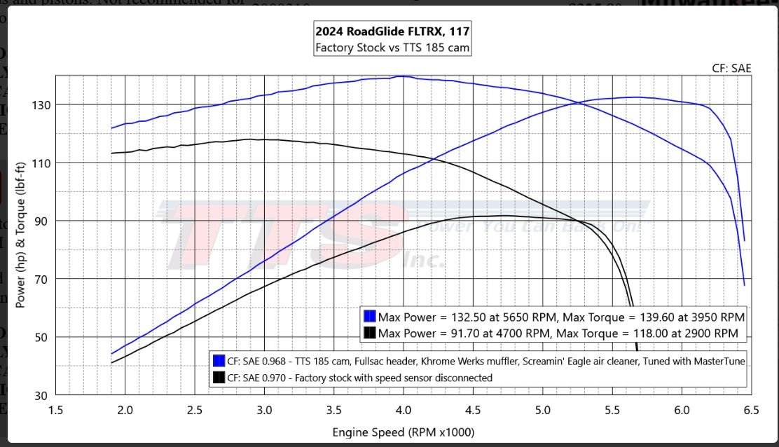

If they will let you return it, just return it for a refund. Then get a MasterTune BT. While your at it, buy the TTS185 cam, it was developed especially for the Gen2's. Then you can get everything running fine, but not matter what cam you run, expect to lose some low end torque because of your pipes. You might not even notice it when you're riding.

Thats a nice looking dyno, but to get there Id have to buy a new cam AND buy a new tuner AND do all the install work again AND trailer it somewhere and pay for the dyno tuning.
Plus my andrews 485 would then just be a decoration

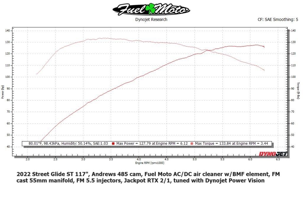

The andrews dyno looks even better (to me). that torque is where I live, in the low to mid rpm, and a much flatter curve, Not quite as high peak torque but very close and much flatter
thats a log and expensive path to follow.

The cam that came in your bike wasn't specifically developed for the Gen2 motors, it was just an M8 cam, so a good tuner should be able to create a map and tune your bike with the Andrews cam in it on a dyno. You might also end up getting a base map from Dynojet. They do try to take care of their customers.
Now let's look at these two dyno sheets.
The TTS185 run is starting at 1900 rpm. At that rpm it is making about 122 ft/lb of tq. The Andrews 485 dyno is starting at about 2200 rpm and it is making about 103 ft/lb of tq. By 2200 rpm the TTS185 is making 125 ft/lb of tq. The Andrews cam doesn't get to 122 ft/lbs until about 2500 rpm. At 2500 rpm the TTS185 is making 128 ft/lb. The Andrews maxes at 134 ft/lb at 3440 rpm while the TTS is making that torque at 3100 and goes on to max 139.6 ft/lb at 3950 rpm. So in the low to mid rpm range where you like to ride, the TTS actually did do better. Now you must consider the TTS185 was in a Gen2 motor and the Andrews 485 wasn't, so that could account for some of it.
I'm not dissing your pipes. Pipes are usually a trade off between looks, sound, and performance. Like I said, the pipes you bought might be alright, but they might cost a bit of the low end if they are too open. But they will look and sound good.

Remember the sheets you guys are looking at are Touring Models. Take a few points off for softails- dual counter balancers and less exhaust volume changes the numbers and shape of the curve.
oh yeah. I know all bikes are different. I wouldnt expect those same results.
