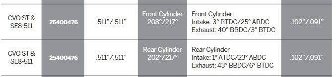

If this is the case, he already has a map. The bike has a map in the ECU for the cam it came with. That is this cam: CVO™ 25400273 Lift @ Valve: .432"/.445" 188°/212°
Intake: 11° ATDC/19° ABDC
Exhaust: 47° BBDC/15° BTDC
TDC Lift: .044"/.044"
He should be able to go from this. If he needs something more, you can pay FuelMoto for access to their data base to download the map for a Low Rider ST. Here are the specs for that cam.
If he can build it from a map for an aftermarket cam, he should be able to build it from a map for the cam that comes in it or an LRST.
