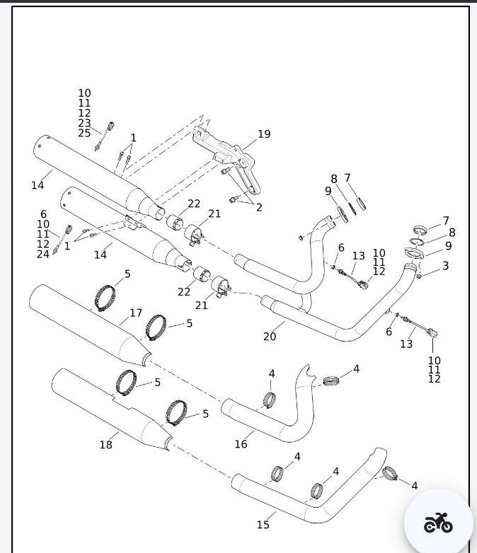

In the process of installing Tab Performace with Zombie on my wife's 2025 Fat Boy Gray Ghost. Lady Luck struck but not in a good way. Head of bolt broke as I was tightening the last bolt. Searched everywhere to discover the size needed. 3/16 socket head mounting bolt. Any and all help greatly appreciated. I ride my 2019 Freewheeler....Arthritis caused me to sell my SGS. Cannot trust my L ankle or foot.

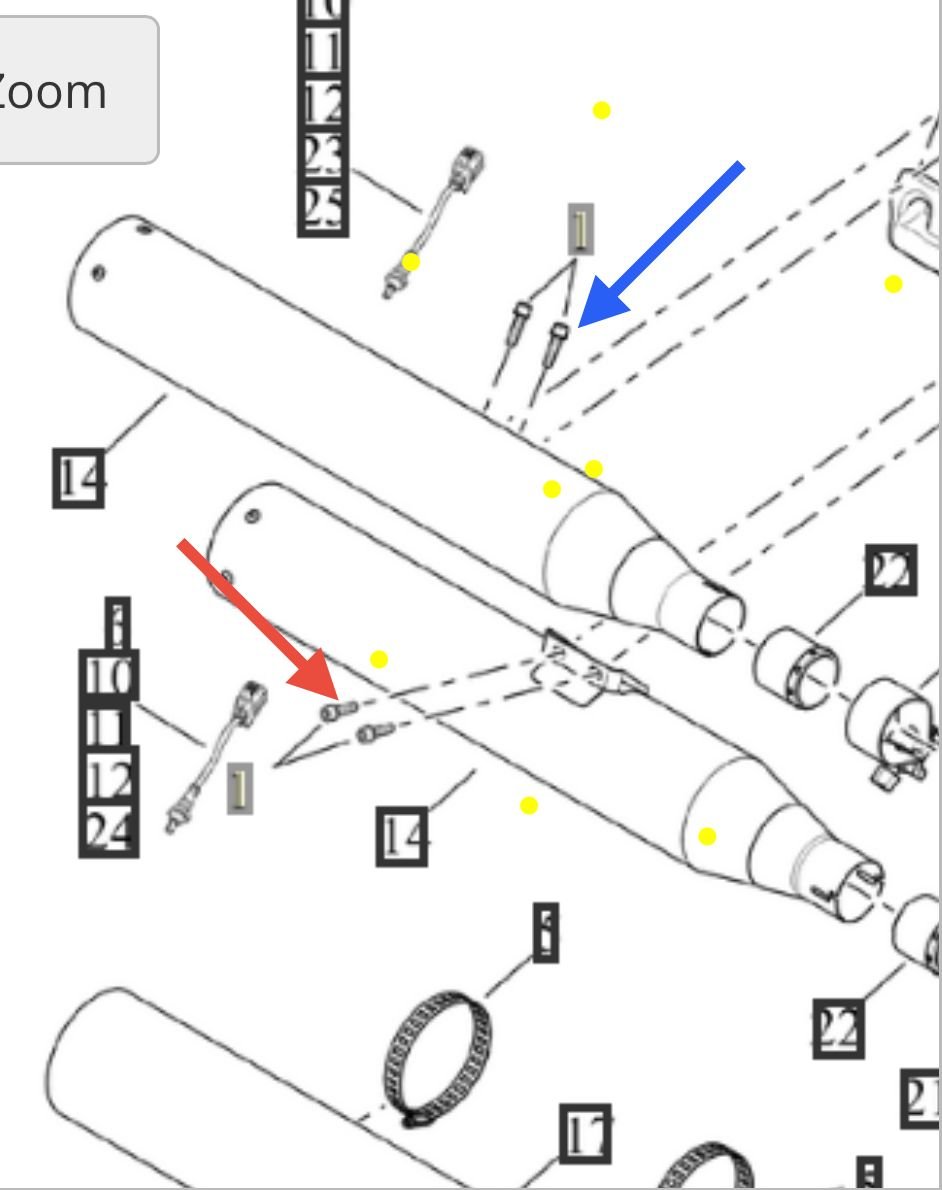

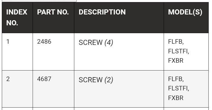

Red arrow is a 2486 1/4-20 x 1 hex socket SEMS/Lock
Blue arrow is a 4687 3/8-16 x 1 hex socket SEMS

Thank you. I apparently mixed up the bolts. Will buy new ones after extracting the broken bolt. My mistake. Now will face the music.

They have two things labled #1 in the parts diagram that are different? Oh man.
Old Jul 31, 2025 | 03:51 PM
GalvTexGuy's Avatar
GalvTexGuy
Joined: Apr 2015
Posts: 10,106
Likes: 5,350
No.

Are you sure about that? Both of your arrows are pointing towards index #1. Index #2 is 4687.
