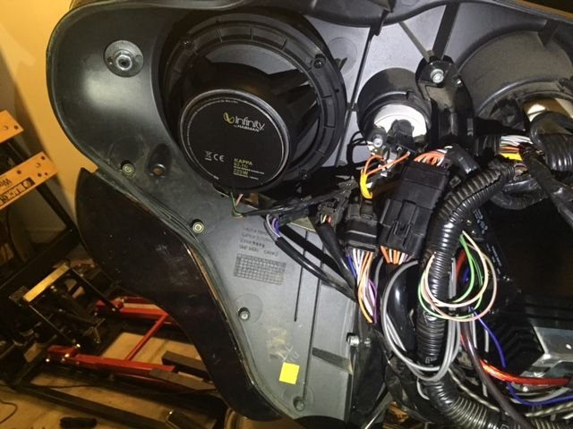

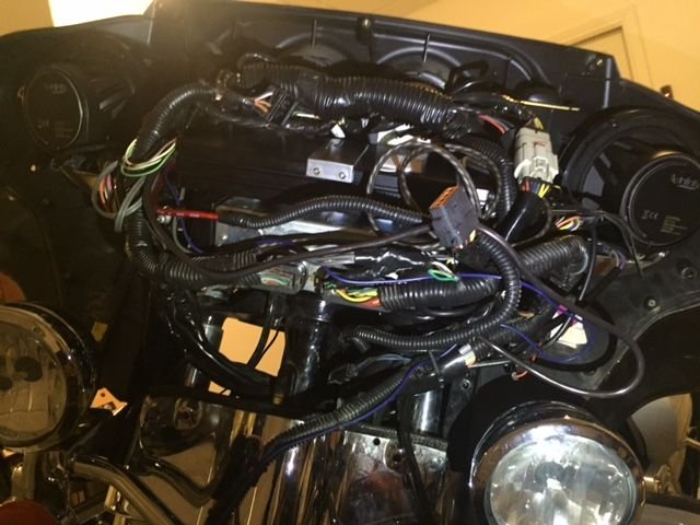

No there is actually a ton of room by the speakers, holding it all in place it's the stock 2 radio harness' that is cruising the issue. With the xm module on the top of amp sitting sideways it hits that to. I'll go snap some pics and see if I can upload.
Old Dec 31, 2015 | 09:53 PM
Hossie's Avatar
Hossie
6th Gear
Joined: Dec 2015
Posts: 11
From: Houston
It looks like a bomb went off in there at the moment but the bottom connectors for the radio seem to be the biggest issue. That and the ones on the right side by the support bracket.
Above is the closest I can get it pushing in on it

Maybe fournierrandy can help you out. He has some pic of his install in this thread. One difference is he is using an aftermarket HU.
I suspect the fairing is hitting the front edges of the amp. Look for scrap marks on the inside of the fairing.
Some have had to grind some plastic of the back of the gauges to slide the amp back further to clear the fairing.
