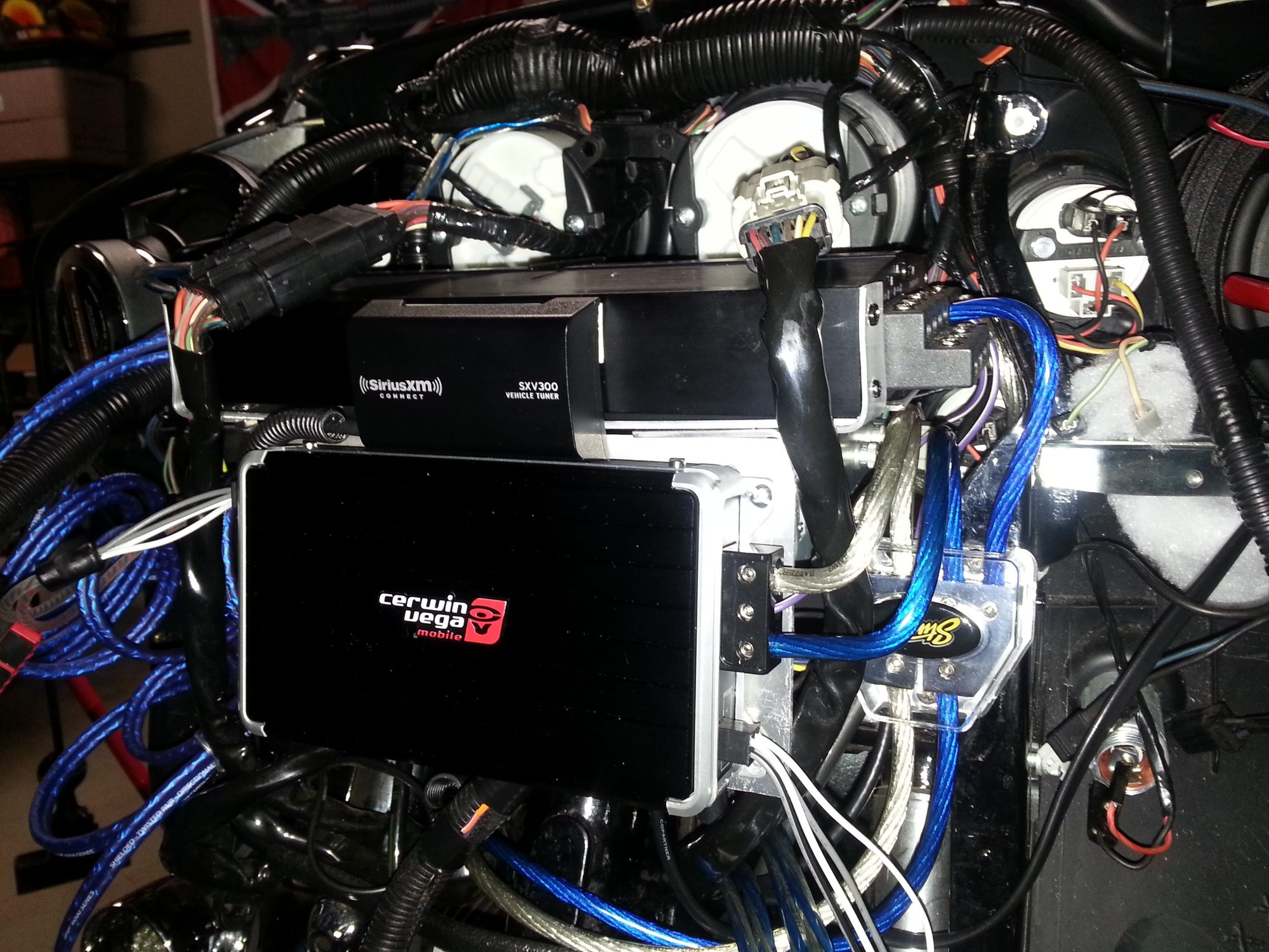

Im an ebay junkie. Thats where I found this d-block by Stinger for $20. Houses 2 lines for power and 2 for ground.
As far as 2 amps go, you'll have more sound. You didn't state how you have it wired, so I'm assuming you are wired 1 speaker per channel?
You could run the fronts in parallel and dedicate the rear to the 6x9s. But i just don't think that it's enough power. Personally, I would look at something with more *** than the micro4. 80x4 just isn't enough at 80mph. 150 X4 would be better. Imho.
