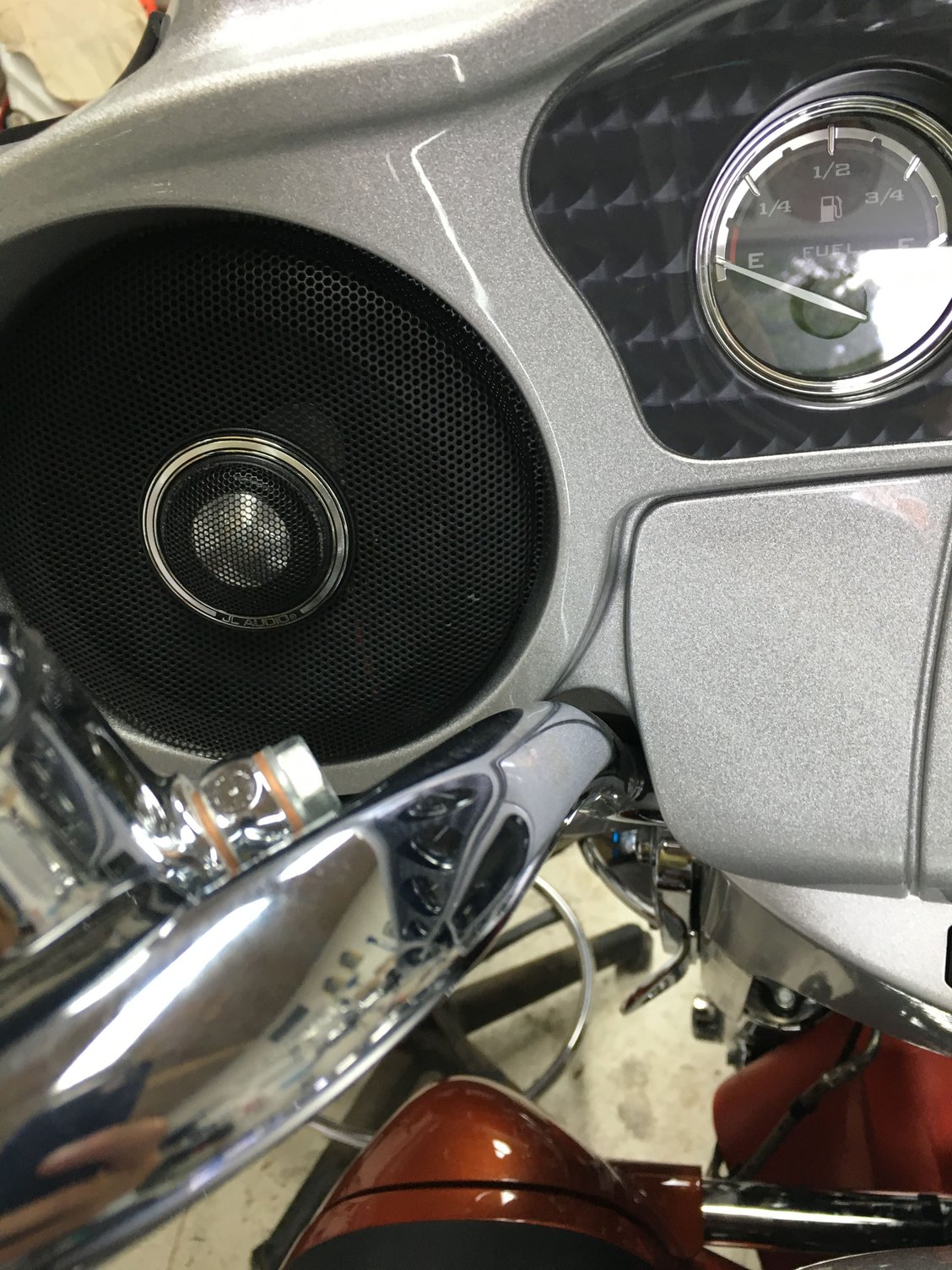

COMPONENTS BABY!!!
That's what was missing. Kept the focals in the rear, JL ZR650-CSI front.
Running break in on speakers now but what a world of difference! Dialed in the BTLL yesterday and re adjusted amp.

^ I like this guy. Talk about no BS'ing when chasing better sound!
Looks great man

Awesome move Tes!! And very clean install of the tweets!!!
I really do think the component speaks in the fairing is the best way to go if u don't mind drilling the grill hole and the crossover storage.
Throw up a vid of a speaker challenging tune if u get a chance as we would all like to hear those ZRs.
Any issues with finding a place to feed the tweet wire without pinching it? I have the BT brackets so a nice little gap already exists.
Dynamat ur outer fairing next?
T.

One step ahead of you! Dynamat already done but I'm probably going to put some on the bottom half of the fairing under the speakers. I will post a vid asap
