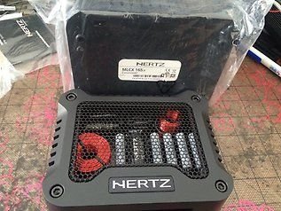

Originally Posted by slyedog
Install looks nice and well thought out. Crossovers can be a fight. Mounting these monstrosities was quite the process.
Good god man, looks like a small amp... It was a blast trying to cram the JL crossovers under the hood, I'm sure those were fun too.
