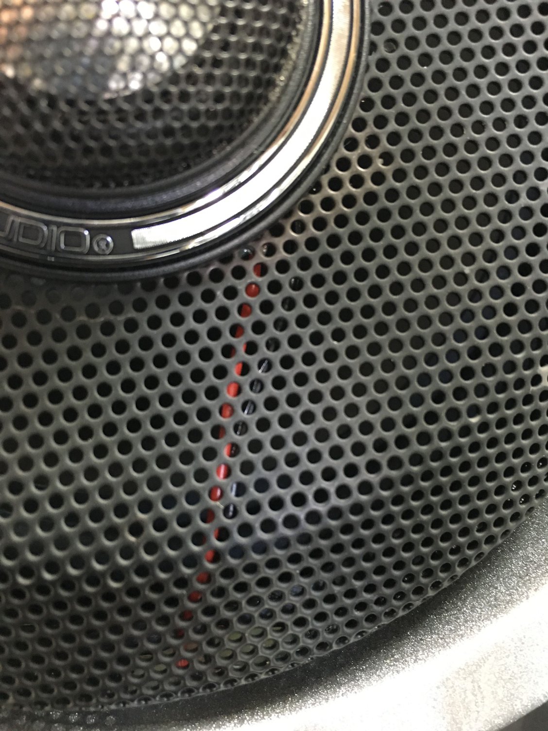

I've got the brackets too, thank god. If you look at the picture you can see where the tweeter wires are. After i cut the hole, dremmel, I hot glued the tweeter in from the backside also hot glueing the wire to the side of the tweeter them again at the curve of the grill. That allowed the wire to sit between the front fairing and the bracket. I put a little silicone on the wire to keep it stationary there too. Easy with the brackets.
Hardest part was getting that damn crossover mounted. It's as big as the speaker.
Spent several hours on the phone with mike from BT yesterday. We finally got base settings/frequency/voltage settings for the BTLL from them when they ship. This will allow anyone who wants to play with the LL to go back to base settings. Got a lot of other measurements for stock 6.5 head unit too. All of this made setting up the LL they way I wanted it to sound so much easier. Not to mention finally being able to level the front/rear speakers that HD/HK managed to SCREW UP. I will post all of hat this week too

Very nice job on installing the tweeters in the grills.
Getting the the LL back to default after adjusting the HPF is a PITA. What I found was that each slight adjustment on the HPF effected the speaker output gains on the BT amp. So it turns into a balancing act. When I talked to Mike he had mentioned coming up with instruction on how to make these adjustments. I would be very interested on what you learned from Mike.
