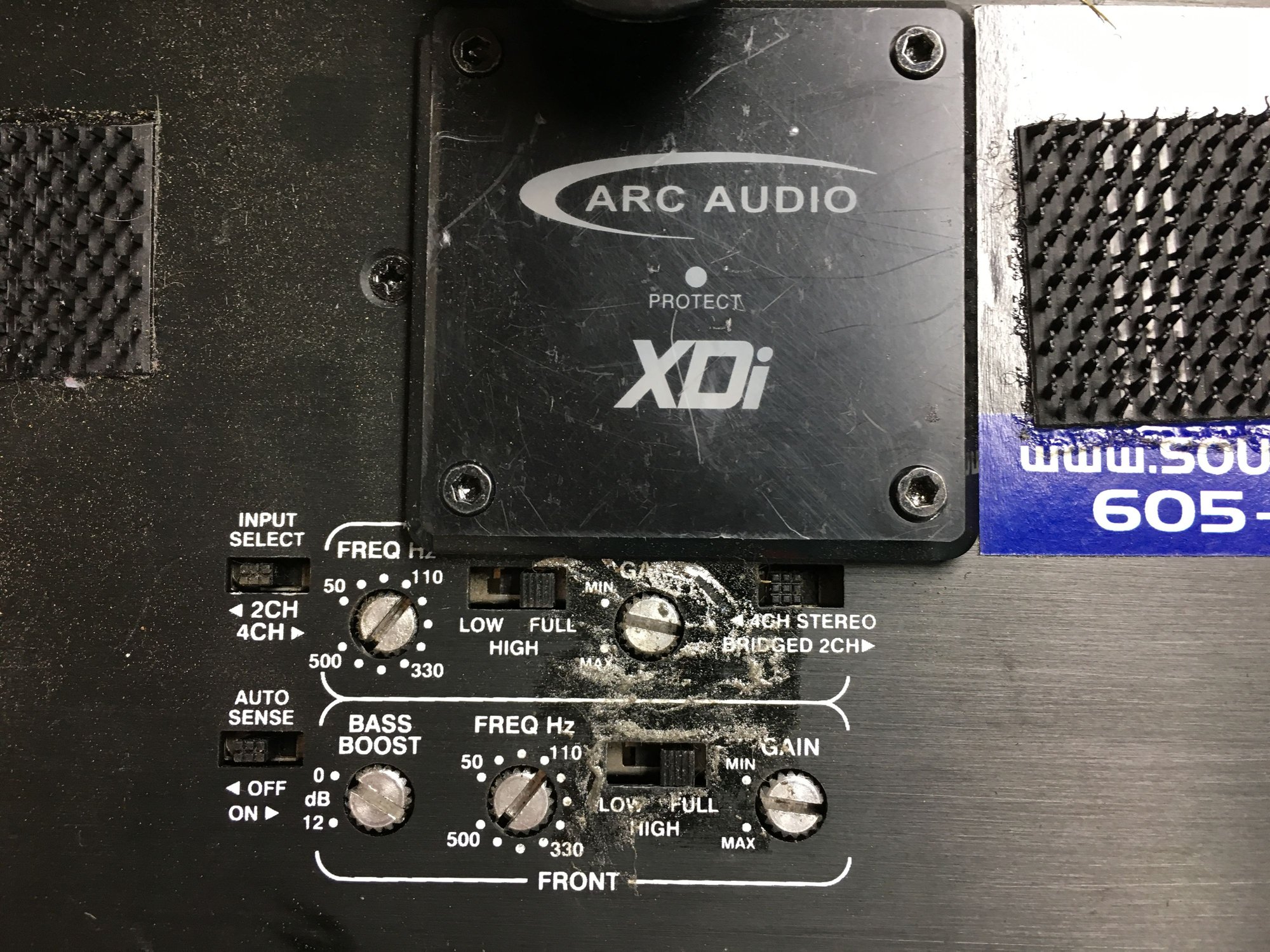

So I have the Soundz Customz level 4 (x4 front and rear focal ec165k speakers and the arc audio 600.4 amp) on my 2014 cvo. I am very happy with the setup BUT would like a little more of a "full" sound from the speakers.
Would replacing the front and/or rears with the Hertz hcx 165 (or whatever may be recommended to match the amp) merit me anything?
The amp comes in preset with the bypass switch set to full for high and low. I've since set them to full and adjusted gains down and crossover points for a much better sound but I'm still wanting a little more of a "full" sound. I know bass is unrealistic without bag lids or sub but again I would think I could gain a little more low/mid with better speakers, not that focal speakers aren't great.
Here's how I have the amp set so any suggestions would be appreciated on the settings
Thanks

If you set the amp to "Full" the crossover adjustments do nothing. If you want to adjust the crossovers, you need to do so on "Low" or "High" ("Low" is for subs). I have my crossovers set on "High" and at about 90/100 Hz. I have no issue with the quality of sound, just the loudness.
Turning the gain down only reduces the voltage coming out, if gain was set with a DMM (in your case with a 600.4) to 24.5 volts then your set for the max for that amp.
The best thing I've done to help fill the sound was to use sound deadening material around my pods, not sure how you have the speakers mounted in your fairing but there a several threads to help with the best setups for batwings in terms of mounts and pods (or lack thereof).

Although I don't really use fade besides testing wonder why he didn't run a rear harness with LL when installed? And is there a LL on the front? Amp set to 2 channel input so assuming flash no amp 4 speakers? I'm not quite so into knowing the flashes since I don't have to, just what I have saw here.
Old Aug 3, 2016 | 09:06 PM
Bunker's Avatar
Bunker
Joined: Aug 2013
Posts: 2,449
Likes: 495
From: Port Arthur, Texas
Soundzcustomz uses a 2 amp 8 speaker flash, with the 600.4 you only need the front channel input as the amp will split the signal to 4 channels. High level input, no LL (fader doesn't work anyway with the 2 amp 8 speaker flash)
