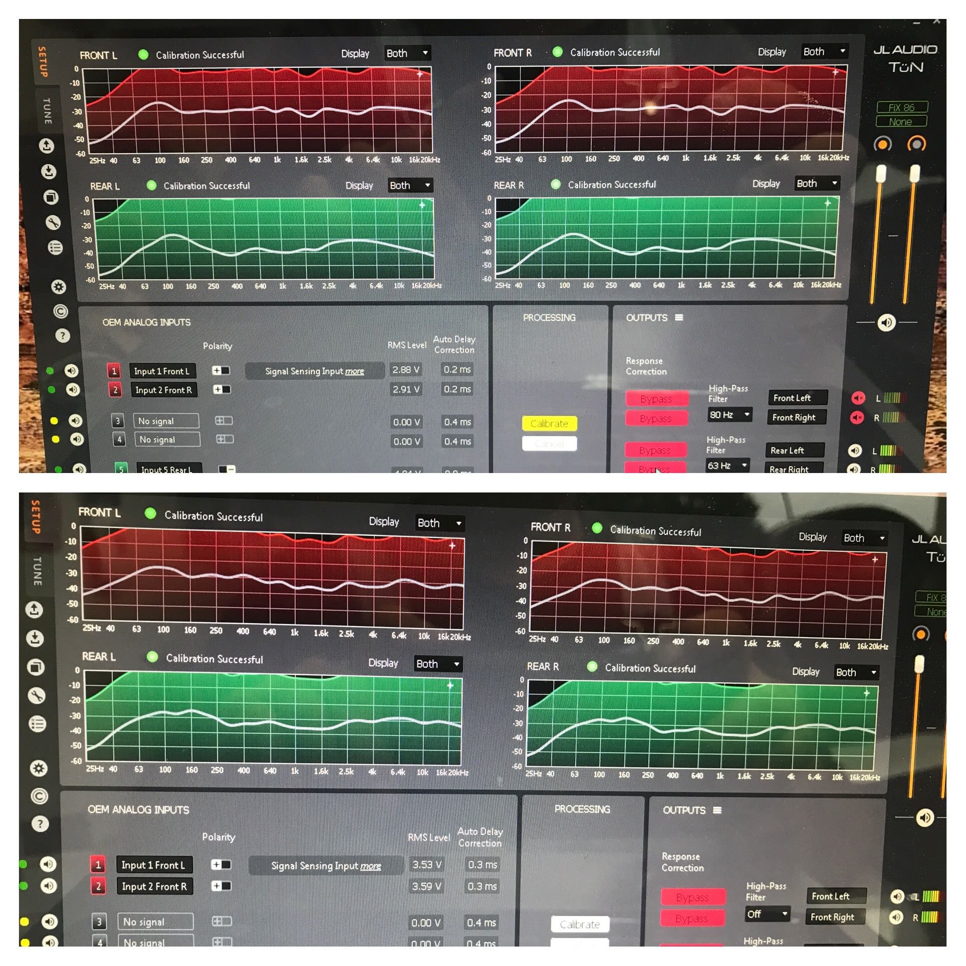

For those that wonder/question if the boom headunit actually changes the audio bin file from one to another AFTER the bike starts, here you go.
Not only does the DSP curves change but the voltage/wattage also changes (lowers the rears significantly and slightly lowers the front) when the bike is running.
Bottom line running something like the arc audio psm or the JL fix (which autosums the voltage across all 2 or 4 channels) is a great idea when running aftermarket amps/speakers.
Is it necessary, absolutely not. Running the BT LL's will always be a option. It really just depends on what you want out of the end result sound.
The top pic is with the bike runnnig and the bottom pics is with the bike off. For those of you using the fix, calibrate it with the bike off and adjust as needed with the bike on. Just don't forget to set the speaker out voltage, in the fix software.
What do you set the speaker out voltage to and you change it on run. What will that do. I still notice the difference between the on and off bins. How can you eliminate it or can you.

What speakers/amp are you running? And what wattage are you running them at?

Originally Posted by Tstreet15
ddvo3, hertz sv165 diamond 800.4
Look at the above pics and you will see in the lower right hand side where it says OUTPUTS with the 3 bars to the right. Left click the bars and a new window pops up. This is your speaker voltage output. This sets the speaker out voltage from the dsp to match the speakers to the input to dsp voltage. I'd set your about 1v and adjust up/down as needed for the sound quality.
Be careful as this will raise the voltage out/wattage to the speakers. Don't over drive the speakers but you should be good about 1v.
