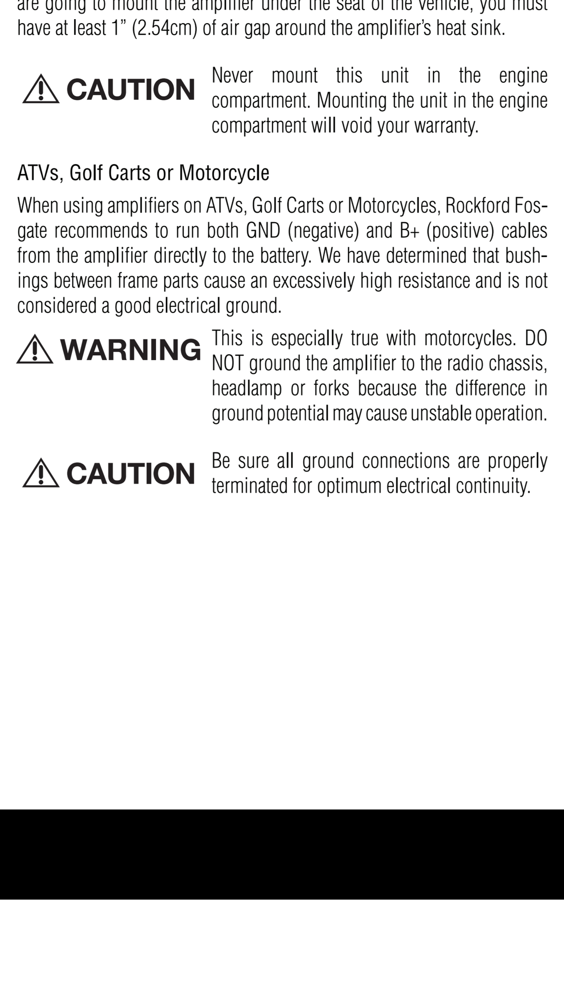

Originally Posted by bigreds1963ss
Did you say you were grounding the amp to the battery? That’s not a good idea. You never ground the amp off the battery.
Explain this please.
Aaaaannnnnd, who told you this???

I guess I really don't understand how making a connection right at the source is a bad idea. Why depend on a connection via another connection, via a floating ground to get there.
I'll wait for the answer and logic to that!!

If your amp is more than 18 inches away from battery you’ll get interference. The further away the more interference. But you gurus know this cause your smart.
This absolutely does not apply to sled audio.

Ok please school me on grounding. Yes I read the previous posts and my question is, Can you ground to your main chassis meaning not the front end at all but somewhere on main chassis. With all the posts and info overload I haven't come across saying you can't. Yes I'm new to all this and learning while saving for a sound system, and not trying to start an argument. I trust those that are knowledgeable in this area. Thank you for your patience.

There's a grounding post in front of the battery (some are on the left side of the frame) that is used as well as grounding to the battery.
