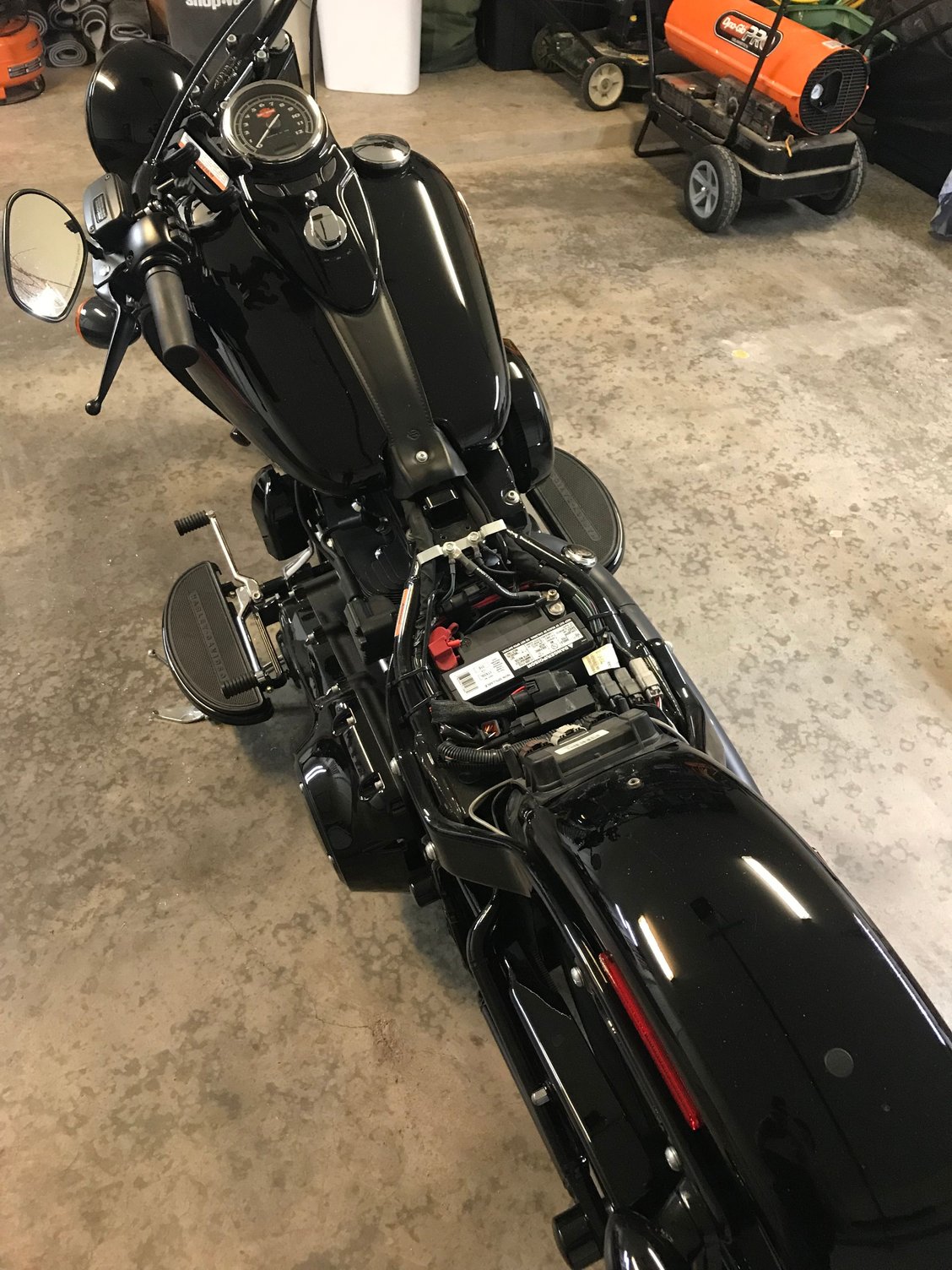

I recently bought a radio and speakers for my 2016 Softail Slim FLSS. I know the basics to wiring I just need to know where to tap into power for the radio. I’ve heard ignition switch or there’s acc to the running lights? I’m just OCD and my bikes to pretty to “rig” it.

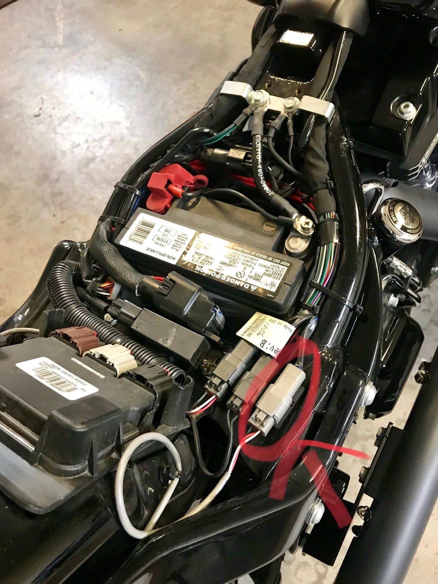

On the slim there is a light gray connector under the seat that has ground, ignition power and battery power.

You could use this connector from HD and make it plug and play.

This looks to be running to tail lights
badass thanks is this what you were talking about?

No not any of those 3, it should be on the other side. It would be a unused plug unless someone add a acc already to the bike.
