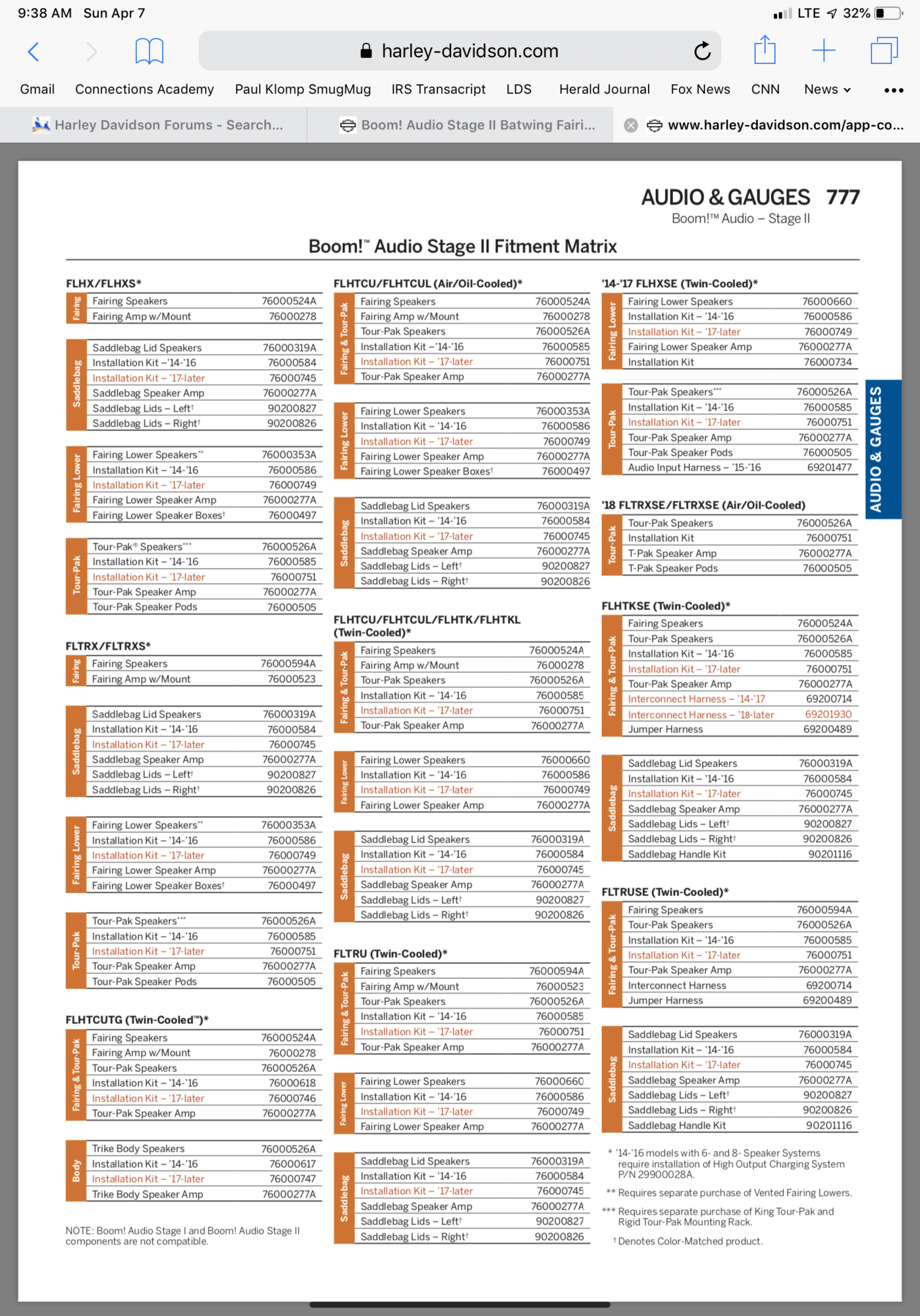

I need help with stereo upgrade. Ive got a 2017 ultra limited low.
Im looking to upgrade the stereo. I’d like to keep the HD head. I’ve looked at boom stage 2 but I’m not getting the answers that I like.
90 percent of the time I ride with the tour pack off. I’d like to upgrade the fairing speakers, add lowers & upgrade the tour pack. I, told that boom 2 cant handle this and the bike will throw codes when I take off the tour pack.
What at solutions do you recommend? My last bike was a 2015 CVO street glide that had 4 speakers and it sounded much better than my 2017 so I’m looking for something like that.
Thanks in advance.
here is the fit,ent guild from Harley

If you have done any reading at all you would know that boom is not worth the time or effort. Let alone the cash they expect you to pay.
But there is some truth to what you have been told those amps will not turn on without a certain resistance sent to them to detect.
You would be head and shoulder above "BOOM" audio for half the money and be able to accomplish what you are trying to do. If you go aftermarket.

Keeping the stock head unit you will need
The biketronics break out harness kit ( comes with 2 line levelers), makes life easy. Do yo already have the detachable TP harness in play?
A good 6 channel amp or you can have a 4 channel amp under the hood and a 2 channel set up in the TP that will be hooked up while attached.
Lot of ways to skin this Cat but, stay away from the kits like J&M, Soundz and hogtunes. There is way more to be had for less money than they sell those kits for.
Will you be installing this?
How much are you looking to spend on equipment?
Are you versed in Audio (terms, understanding equipment, know how this works)?
