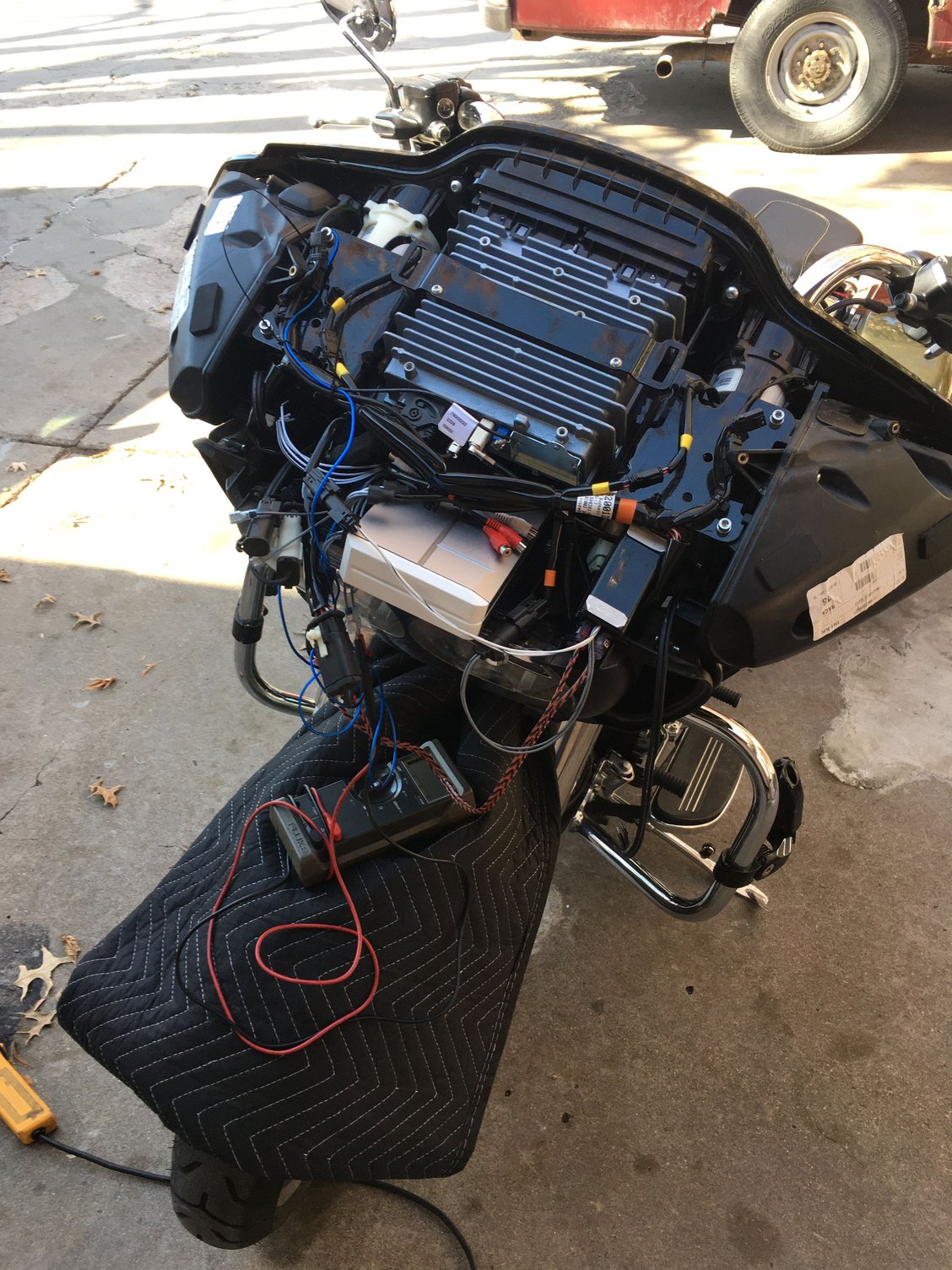

Originally Posted by CuttDogg
where did you mount the amp? Can you post a picture.
I cut off the tabs that hold the wiring on the top of the headlight and it slid right in there. I used the Velcro that came with the amp to secure it to the headlight.

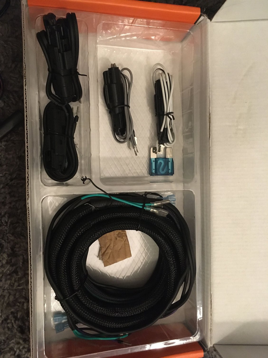

Honestly I did not use much of the Stinger amp wire kit. I used the positive, negative, speaker wires, and the amp trigger power wire. Your factory harness will plug into the BT355. Then your RCA cables go to the amp. I pulled out the factory wiring for the speakers and ran the heavier Stinger speaker wires. Since you’re doing 4 speakers the whole kit might make more sense for you. It’s a pretty good quality kit.
I used one BT355 since I only did the fairing speakers. No flash required. It’s my understanding there are 2 Bt355’s, one for the front and one for the rear. You’ll have to specify when ordering.
As far as the amp mount goes, a mount may be better. But the back of it does hang off of the headlight some, maybe a third to half. I don’t know if you’ll gain much with a bracket. I guess it’d be your preference on how you want to mount it. Some guys turn them with the plug ins and adjustment ***** out. Some tuck them under the factory head unit with Velcro or brackets.
Here’s the kit
Here’s the pieces I didn’t use

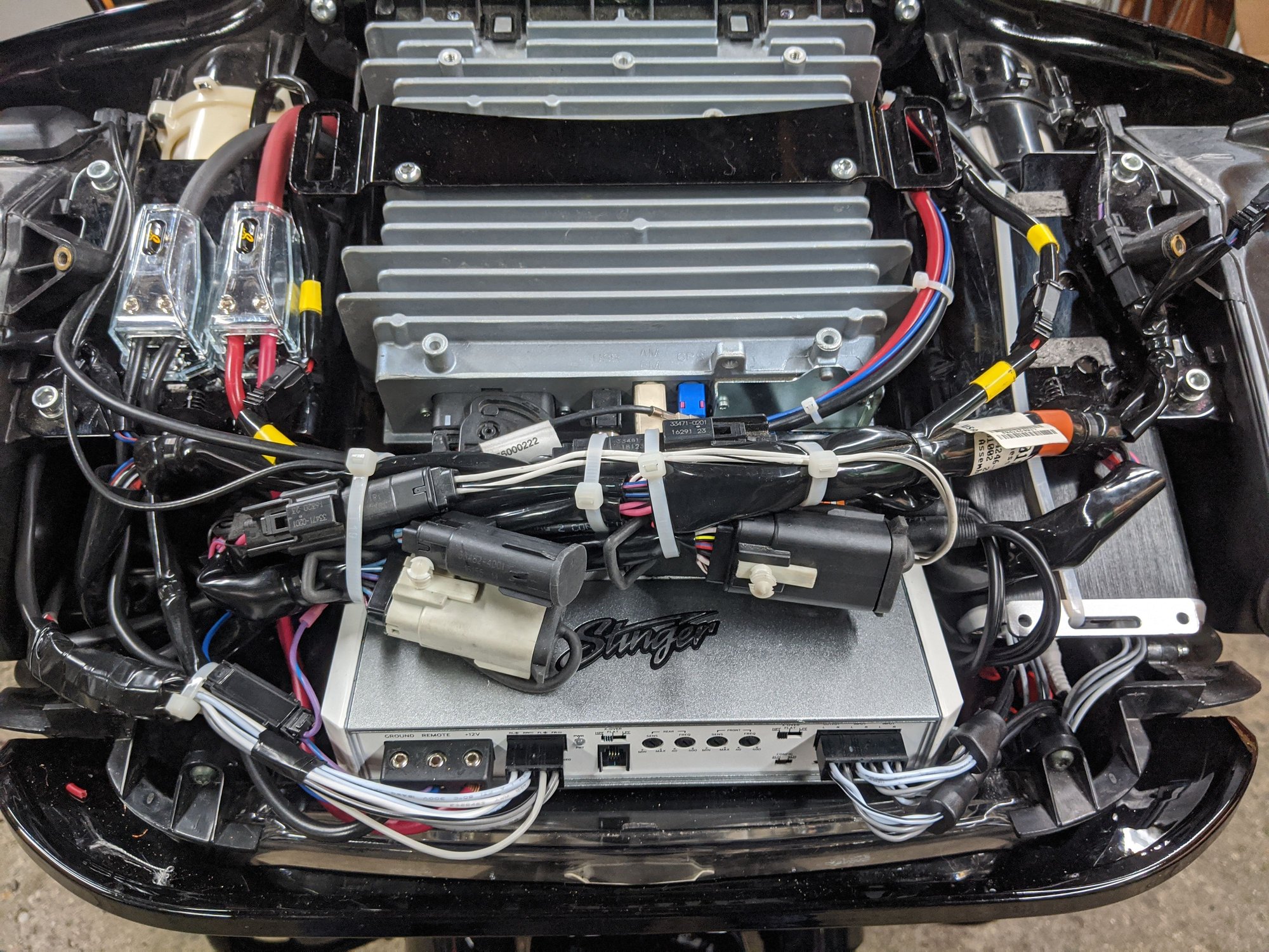

Here is how I mounted my amps. Fits great with ez access to make adjustments.
