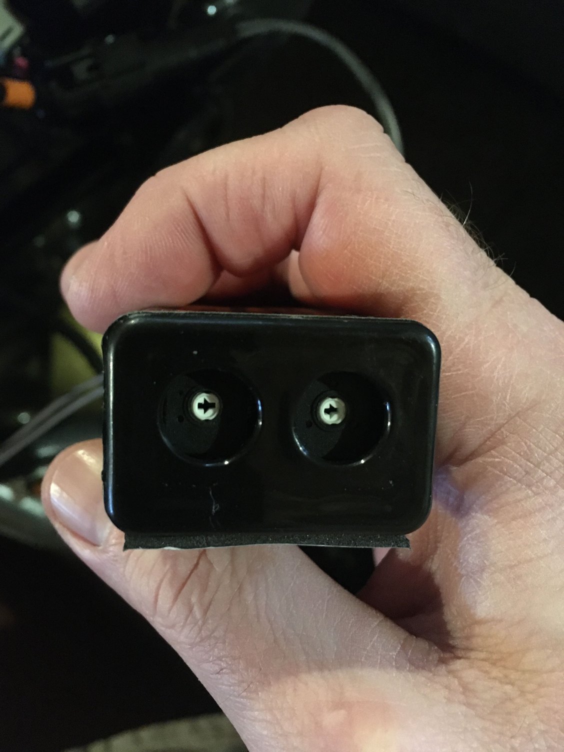

My speakers are installed using the stock speaker wires/connectors. The power wires are run down the backbone. My question is about the amp connections. I’m using my stock Boom 6.5 head unit which does not have RCA jacks like an aftermarket head unit. Here’s how I believe I need to hook it up. Unplug the speakers at the factory molex connectors. The wiring harness that was just unplugged needs to go to the BT 355 line leveler via the factory styled molex connector. Then the other end of the BT 355 needs a short RCA cable to plug into front input RCA harness on the Stinger amp. The line input and rear output will not be used. The grey wires on the stinger amp harness will connect to the molex connector coming out of the inner fairing to the speakers on each side. I will also need to run the blue power wire to the cigarette lighter for a power source that’s tied to the ignition.
As far as the settings on the amp, since I’m only using two channels, the front should be the only one that is relevant.
I've got the front freq set roughly to 80hz. My crossover is set flat. When tuning it I should set the volume at 3/4 and turn the sens dial up until it starts to distort and back off. Leave the BT 355 settings alone as the came from Biketronics. And also turn off the AVC.

I personally don’t recommend adjusting the pots on the BT355. They are so sensitive that it’s impossible to get them the same.

Yes turn off AVC. Yes do not adjust BT355. Other than that, you are in good shape.
