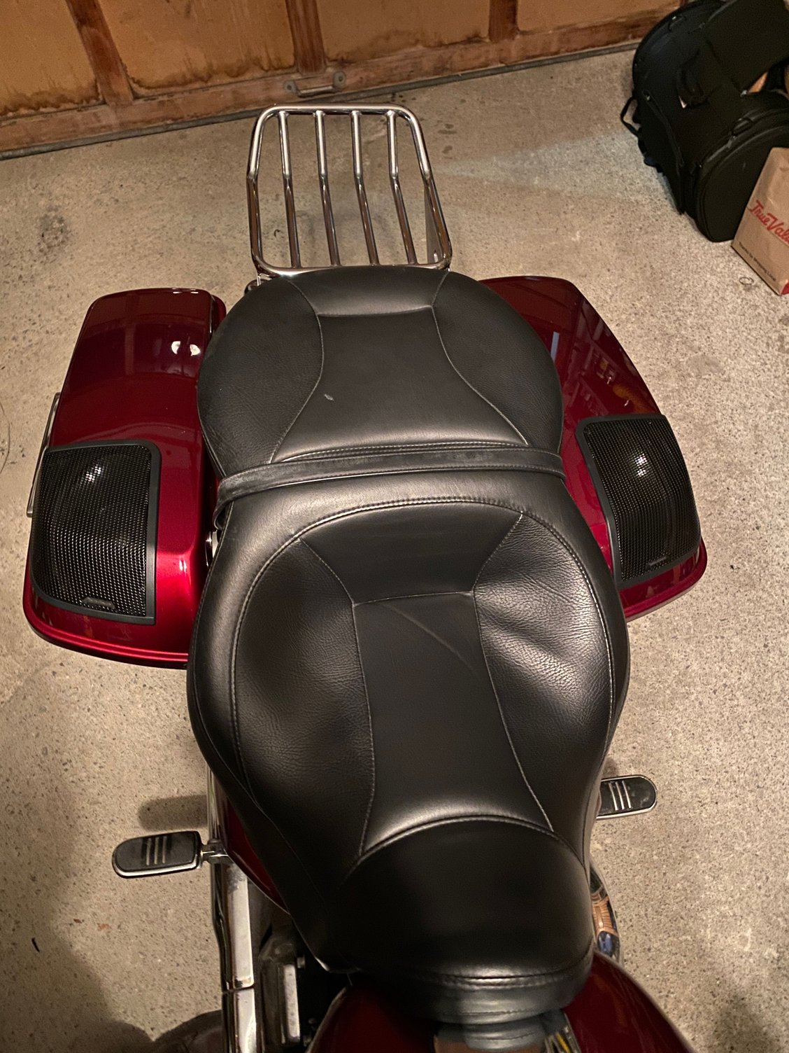

Well everything is in and it sounds great!
the Moto 600.4 is in the fairing and the smaller kicker amp ended up in the saddlebag. I couldn’t find the room in the fairing for both.
I was definitely skeptical about cutting the lids with a jigsaw but the Rockford kit is basically foolproof. We will see how it stands up to rain/washing but it looks solid and sealed.
the Sony xav ax7000 is a definite upgrade from the 5000. 2v preamps on the 5k, vs 5v on the 7k, anti glare screen (although I haven’t seen it in direct sunlight yet, and weatherproof buttons.
