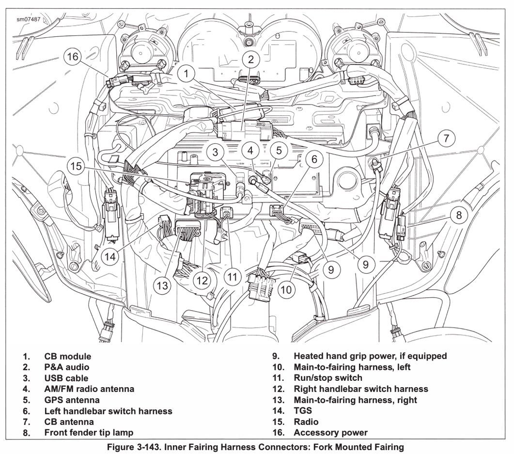

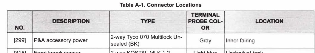

no splicing needed. #16 in the pic is the accessory power plug that’s available. Get the TYCO 070 connector that matches the one in the fairing listed below.

I am pretty sure that the harness I referenced in my first post plugs in there. It splits that into 2 separate plugs, I need to get the plug that goes into the pigtail, thanks for the info on the plug brand. I am going to see if Harley has both, if not I will find it online. The Harness at the dealer is only around $10 so I don't mind paying for it and getting the one that already splits into 2.

Ah, yes that's what 69200921 plugs into. The dash is where the ignition switch is and there are two plugs already plugged into blanks, so when you said under the dash, that confused me.
So what is your plan? Take 69200921 and chop off a connector and splice into it? That way you aren't splicing your main harness?

Something like that. I also need power for a dash cam so I am going to try and find a plug that goes into one of the pigtails. If I can't find just the mail plug I will buy another harness and use the mail from that and have another female left over for something else if need be. Either way, thanks for the info and I will eventually get this figured out and try and make it look like it came that way.
