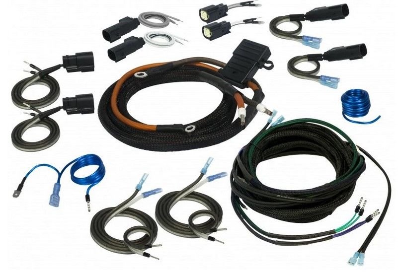

The amp install: The Kit from Stinger, I think\hope has all wiring and OEM connectors in it and is oxygen free copper.
It is described on the web site as follows
HARLEY-DAVIDSON 2/4 CHANNEL UNIVERSAL AMPLIFIER WIRING KIT SKU: SVTK4681
Fits 1998-Present Harley Davidson Touring Motorcycles
it contains bla, bla, bla.. and
"Includes OEM connections for interfacing with 2014 and up models. Works on Street/Electra Glide and Road Glide models"
as shown here:

2) That wire kit is overkill. Get yourself a Saddle Tramp ST-AK8 amp install kit. You then will need a line out converter Saddle Tramp AX-MLOC-HD1 that are made for Harley as a "plug n play". And then some RCA's

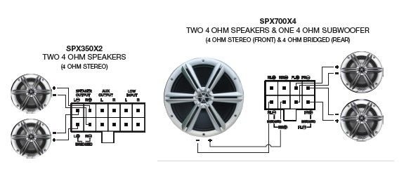

#3 The hook up of the speaker per amp instructions is very confusing in that I just don’t get the outputs needs.
I don’t know if the following is just a suggestion on how you can do something or the amp REQUIRES this output or it burns up or something!
I will try to explain here, and maybe you can tell me if this is “BS” and you just hook it up left and right (I hope)
The SPX350X2 specs say:
RMS Power (14.4Vdc ≤1% THD):
125 x 2 @ 4 ohm Stereo <-- literally the only Amp I see that says I can hook (2) 4 Ohm speakers!
175 x 2 @ 2 ohm Stereo
350 x 1 @ 4 ohm Bridged
Lowest Recommended Load:
4 ohm Bridged or 2 ohm Stereo
The SPX700X4 specs say: This says to me that I "HAVE to have THREE speakers" at the very least, THAT'S what I don't get!
125 x 4 @ 4 ohm Stereo
175 x 4 @ 2 ohm Stereo
125 x 2 @ 4 ohm Stereo + 350 x 1 @ 4 ohm Bridged* (Rear Channels only) <-- Two PLUS One for (3) speakers. NO two speaker instructions
And this diagrams only confirm this!
So, IS the SPX700x4 Diagram fact or just suggestion
As in ANY 2-channel amp no matter what it says in the specs can be setup like the spx350x2 diagram ( with said ohm speakers).
This is all I want “Two speakers in Stereo”
I found this in my forum search and it is suggested by you, I wonder do you still agree?
GZ GZCF 6.5 (200-225 watts needed) with Mmats MD4110, DD Audio D4.125, Euphoria FM 100.4, SD 800.4
If so this is what I will do (one of these amps) along with your suggestions above! I will just look for the least expensive that I can find of these!
and be done with the planning stage!

Short answer is any of those amps will work.
Mmats 4110 is a favorite of mine (it's the exact amp that Soundz uses)
DD is a great amp as well
FM 100.4 is good, but it's physically big
SD 800.4 is the smallest, but there is some reliability issues.
Stinger 700 is fine. I'm just not a fan and I don't like their speaker input plugs.
All 5 of those amps will run (bridge) a set of GZ speakers just fine (as far as power wise and configuration).

OK, so the Mmats 4110 is now the amp - Im easy :-)
BUT, again to be clear
I will only be running the two GZ speakers
Do I have to run them in Bridge mode "mono"
OR
Can I hook them up to this amp in Stereo (2 ch) "ch1 right side, ch 2 left side"
I can find no install instruction "so far" except the image I shared in last post

That Stinger kit is what I have on my 2010 SG. It's a very nice, plug and play, complete kit. I ended up with a few "extra" parts, but they were only speaker wires (long one for rear speakers I assume) and a couple of those plugs which I didn't need because I went with an aftermarket Alpine HU. I removed the tank and ran the main wire harness along the backbone, very clean install and IMO worth the money. It even has that blue wire that is "T'd" off for the remote turn on. it connects to the lighter.
