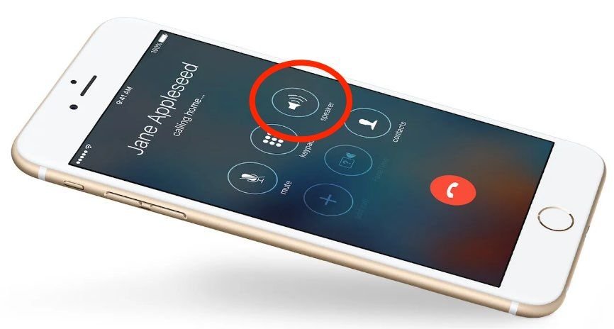

I've had similar recently with HDHU.14si and Cardo Edge. Had all manor of issues with bluetooth on my Pixel 6a and so have to keep deleting or resetting the BT settings on the phone, but I digress...
while parked call your handset from another phone and as the call comes in look at your phone.
on mine there is a large bluetooth icon..like the answer/ignore icon. press and you can direct where the call goes (something like cardo/handset/handsfree/head unit).
Select CARDO and from then on the calls will be answered to the headset.
I've found if you don't do this once, then the head unit keeps taking the calls and the world and its wife hears what simply can't wait and must disturb your zen moment on the bike
YMMV
