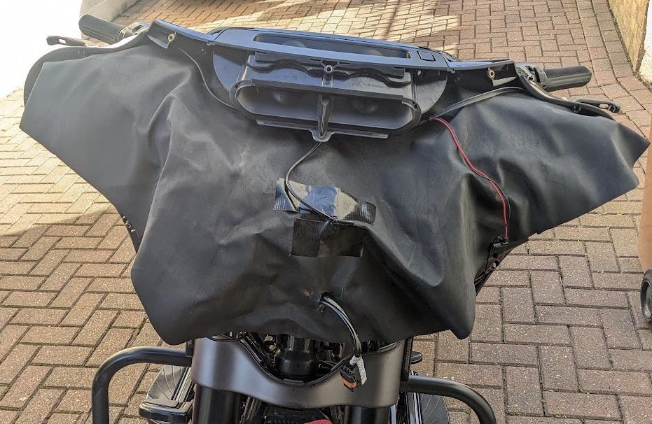

1+ for the 309 Custom Audio shroud (aka bat cape)
i've had one in place for a few years now. No longer issues with water behind the wing.
The amount of water that gets in the batwing is INSANE!
(6.5hour winter ride in torrential rain. this pic was taken 24hours AFTER the bike had sat and before I washed it). And that's why I waterproofed in as many ways possible (plenty of posts on here how to)
had to make a hole for the H-D hidden antenna, but Gorilla Tape deflects any water that heads for the exit
