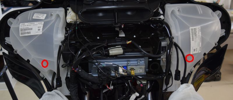

Would it be OK to drill a 1 1/4" hole in the lower part of the pods and push some polyfil in the bottom? Then tape the hole or leave it open?
Don't really want to remove the pods again.

I would not drill holes in these pods. remove the speakers and loosely fit the bottom portion of the pod with polyfil.
If you must drill holes, I would use an epoxy to seal them back up when done

Ok no holes. The next time I have the pods off I'll add some polyfil.
