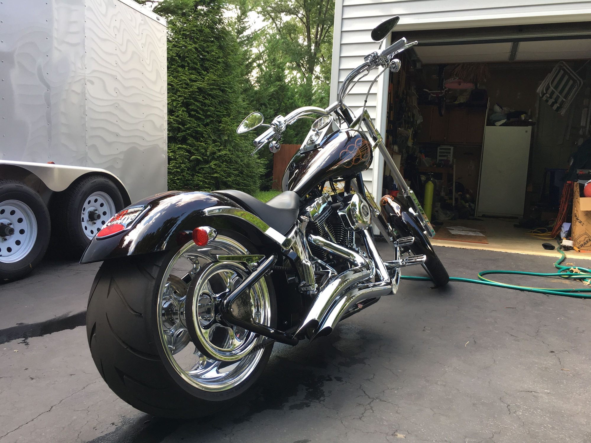

I do like your bars but unsure if they are the Carlini Slickback and I'll tell you why. Our bikes have a hydraulic clutch and to fit on the handlebars there needs to be a flat spot on the bar so the hydraulic reservoir will slide over. This requires a flat spot on both sides (obviously since we have a hydraulic reservoir on both sides. Also, if you look closely, the Slickback is made from 5 separate pieces of material. Look closely at the picture in the Carlini website. There are the two upright pieces, then they weld on the cross bar, then weld on the two handlebars.
From what I see in yours, the upright pieces fastened to your triple tree is continuous all the way up so yours are made from three pieces of material. Can you take a picture of your bars from the front and post it so I can see?

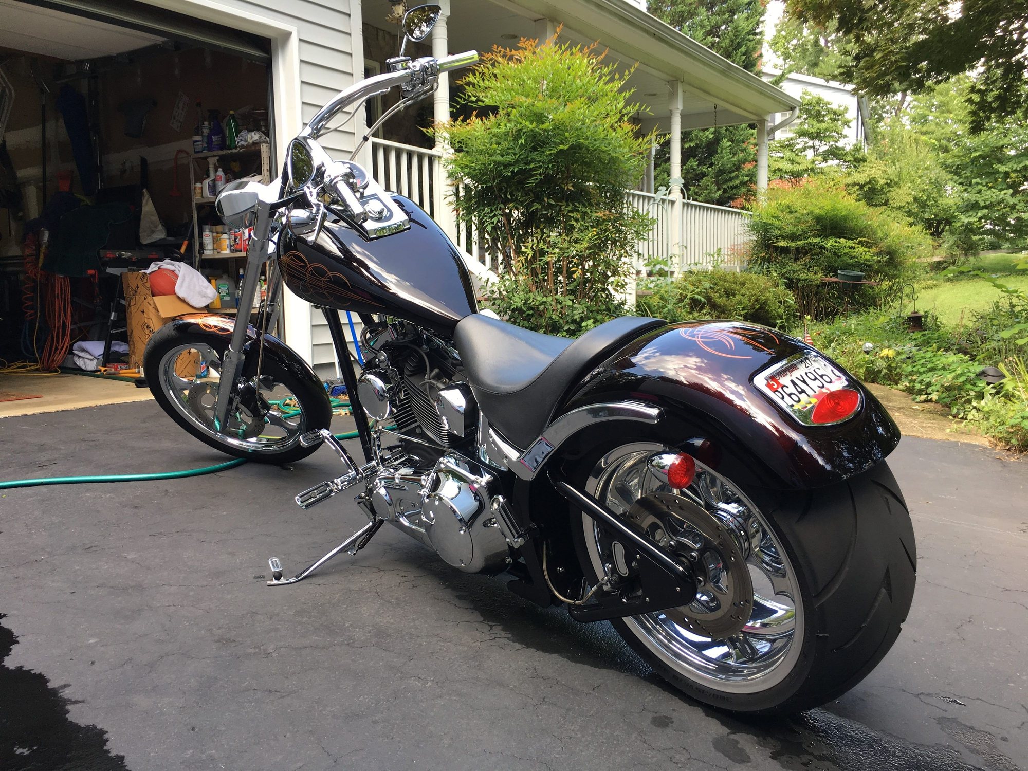

​​​​​​​Sorry Rainmaker haven't been here in a while those look like my bars in your pic. I put 3" risers on it resently. So far I like em!

I'll get better pics for you.

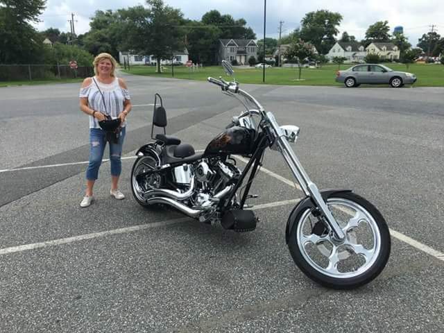

Friend of mine had a TMC Fatboy years ago (R.I.P.) It was a really nice dependable bike and he wasn't afraid of putting in some long miles on it.
Only pic I can find of it but that's it with the guy digging in his bag. He loved digging through that bag lol.
