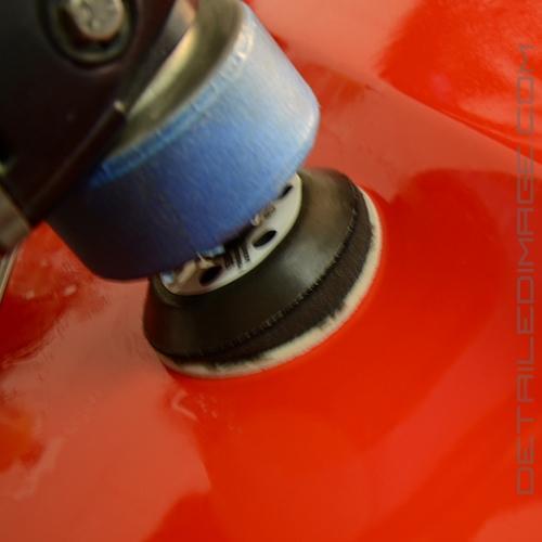

Now the 3" backing plate question:
I strongly suggest the Meguiars Unigrit 3 Inch Professional Backing Plate.
Q:
Why not go use the less expensive 3 Inch Dual Action Flexible Backing Plate?
A:
The Megs 3" discs are 3 inches in diameter. The 3" DA "flex" BP is exactly 3".
The Megs BP is smaller than the mf disc size & the mf disc overlaps the BP.
What does that mean?
That means when you're working close with a 3" BP & 3" disc the risk that
you will hit the paint with the side of a spinning 3" BP is GREATLY reduced.
It is a BIG deal and not worth the risk when the cost difference is only $10.
* If you hit the paint with the side of a spinning BP you will need to repaint.
(Don't ask me how I know) It's not worth saving $10. Do it once. Do it right.
The Megs microfiber discs are excellent and I use them with many different
compounds and polishes. A favorite is Megs microfiber cutting disc & M101.
Follow with a mf polishing disc or soft foam & CarPro Reflect for high gloss.
Take a moment and look at the side edge of the Megs 3" backing plate.
When you bump the paint you'll be very glad the BP is a slightly smaller dia.
