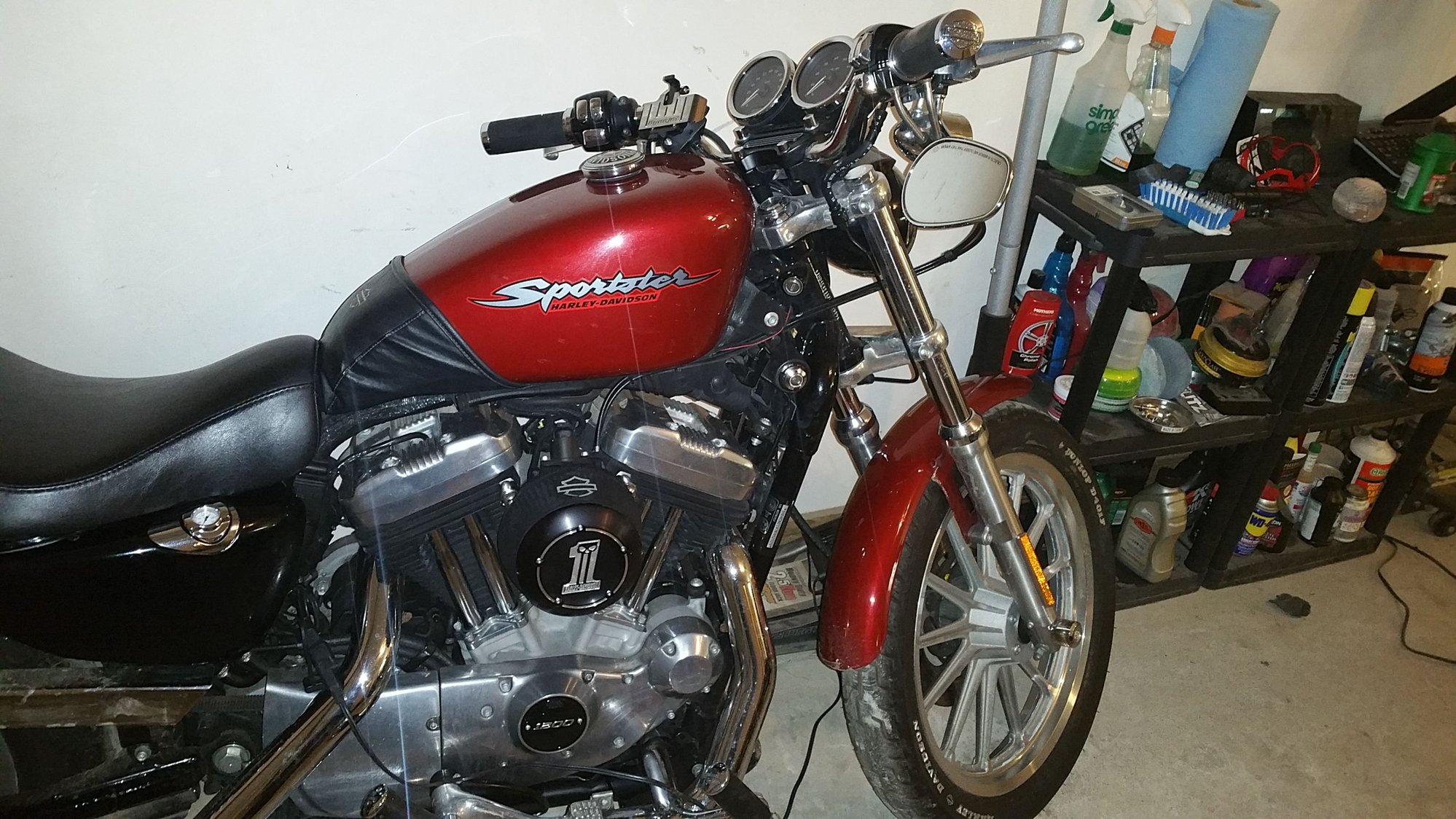

Old Jan 14, 2016 | 06:09 PM
cvaria's Avatar
cvaria
Posts: 12,367
Likes: 2,215
From: Tallahassee, Florida
flippin mirrors is common. no more shoulders!
done to both of mine.
Old Jan 14, 2016 | 06:13 PM
GR_2014 Fat Bob's Avatar
GR_2014 Fat Bob
Stage II
Joined: Jan 2016
Posts: 2
From: MELBOURNE
Looks good! I have the 2014 fat bob with stock handle bars, concerned with the clearance on the tank, might have to go with inverted bar end mirrors...
Old Jan 14, 2016 | 06:44 PM
cvaria's Avatar
cvaria
Posts: 12,367
Likes: 2,215
you would adjust them out ward. your tank is the same as mine.
swing by the hard ware store and get the thread, pitch, and length of your mirrors threaded portion and replace them. enjoy your bar end mirrors.
