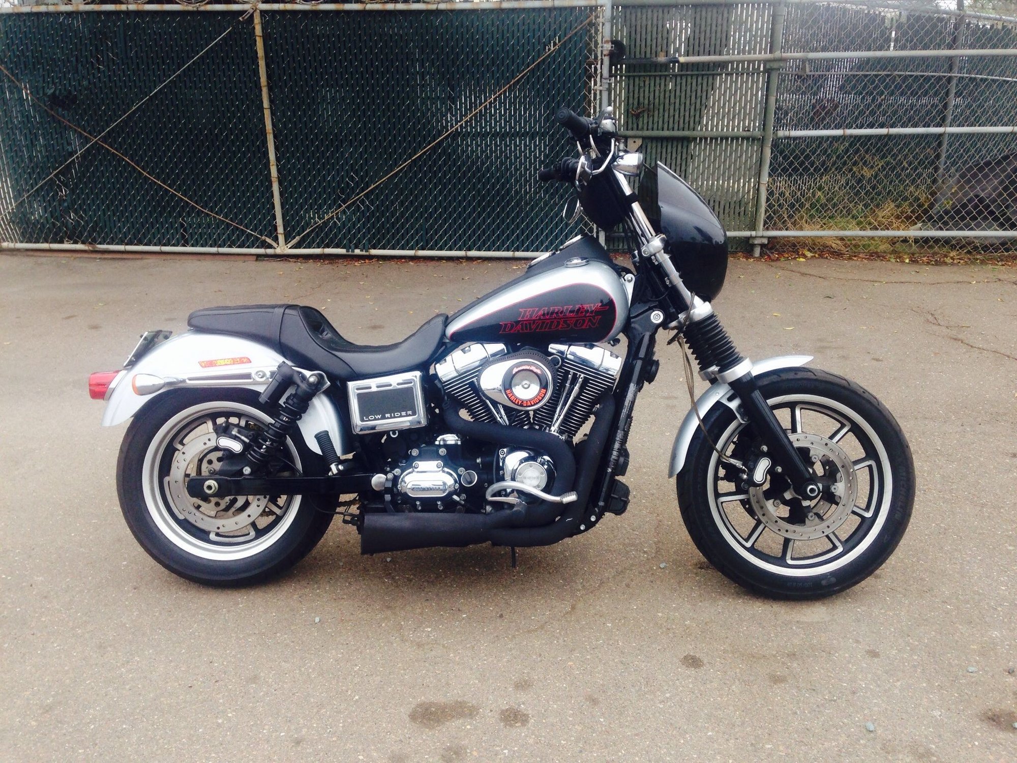

I removed the cat from my low rider, does help reduce heat around the foot, also makes a bit more sound as the cat looks like it is quite restrictive.
