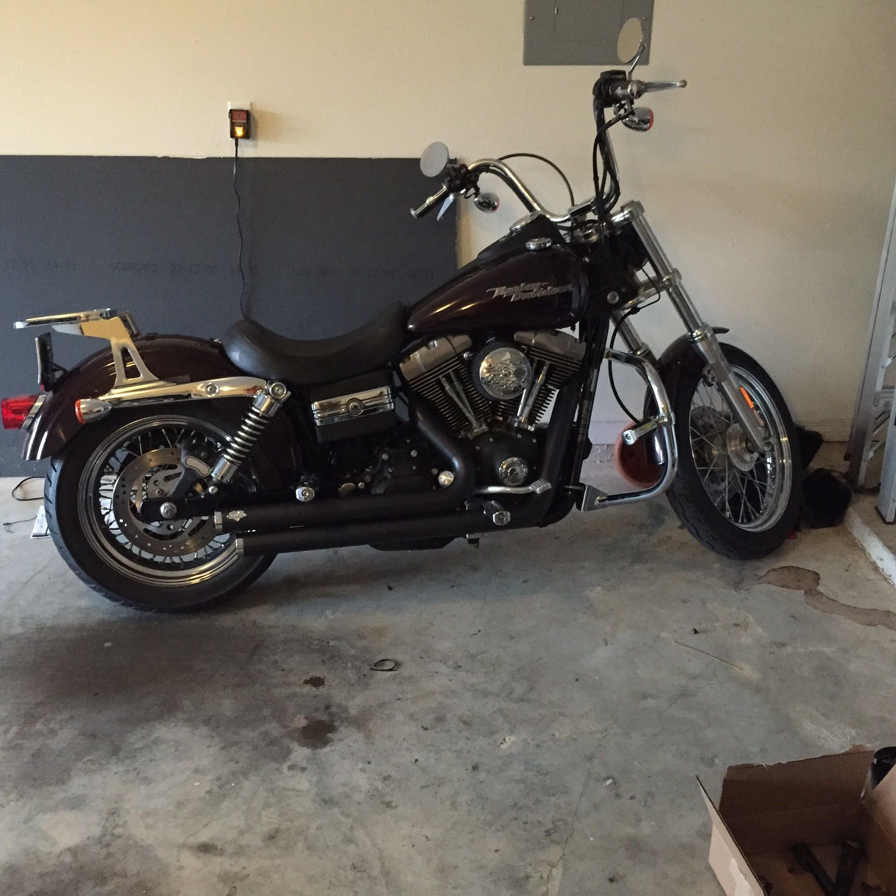

They squealed and moaned, but they eventually came off. Used PB and soaked them twice.... Installing the big shots wasn't hard... Aligning the headers by myself was a bit challenging, but it's done. Sounds hellacious (hope the neighbors don't hate me). Looks pretty nice too....
06 street Bob with V&H Fuelpak, V&H naked Air cleaner, and V&H Big shots staggered... black cherry.....
