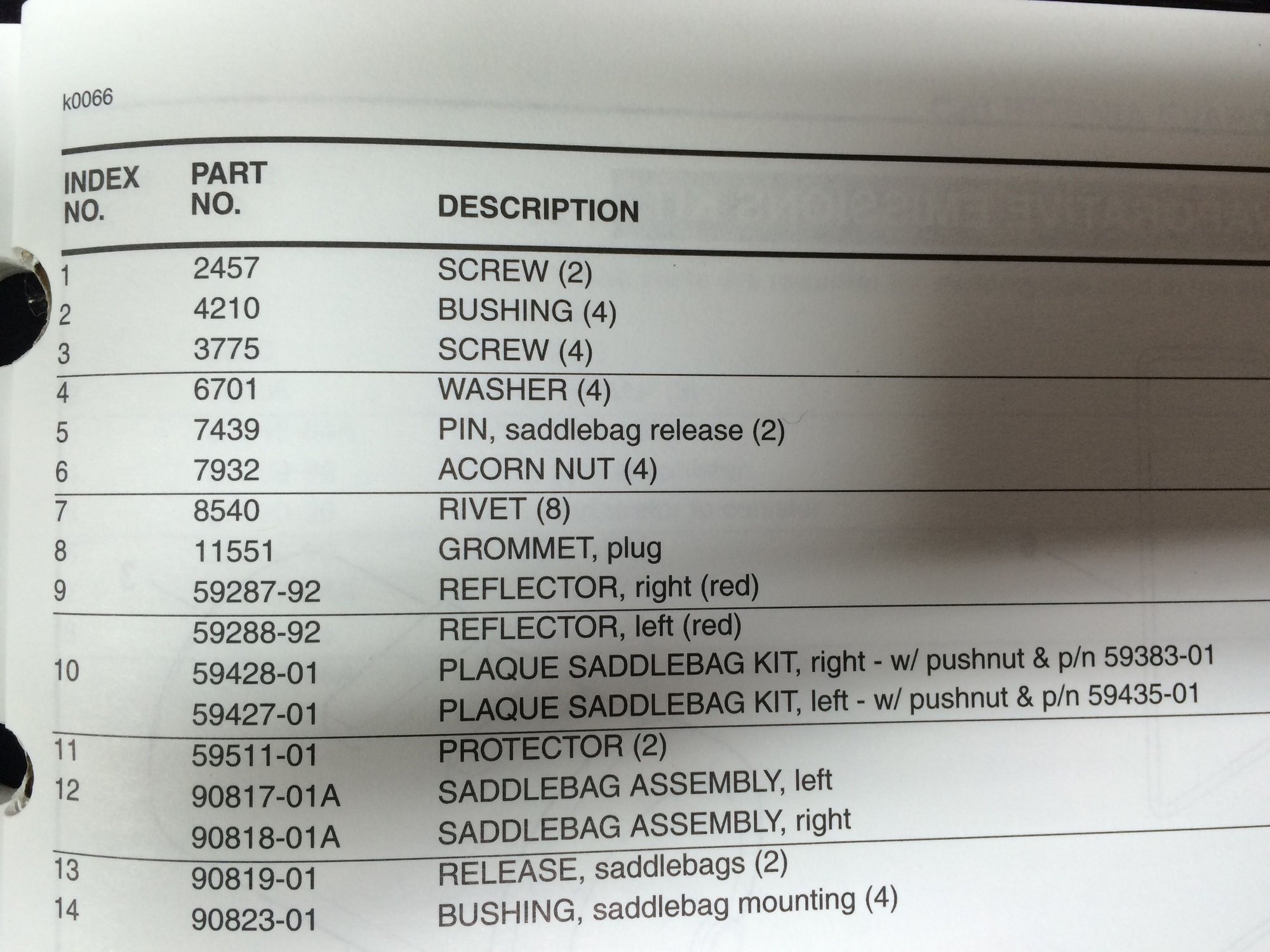

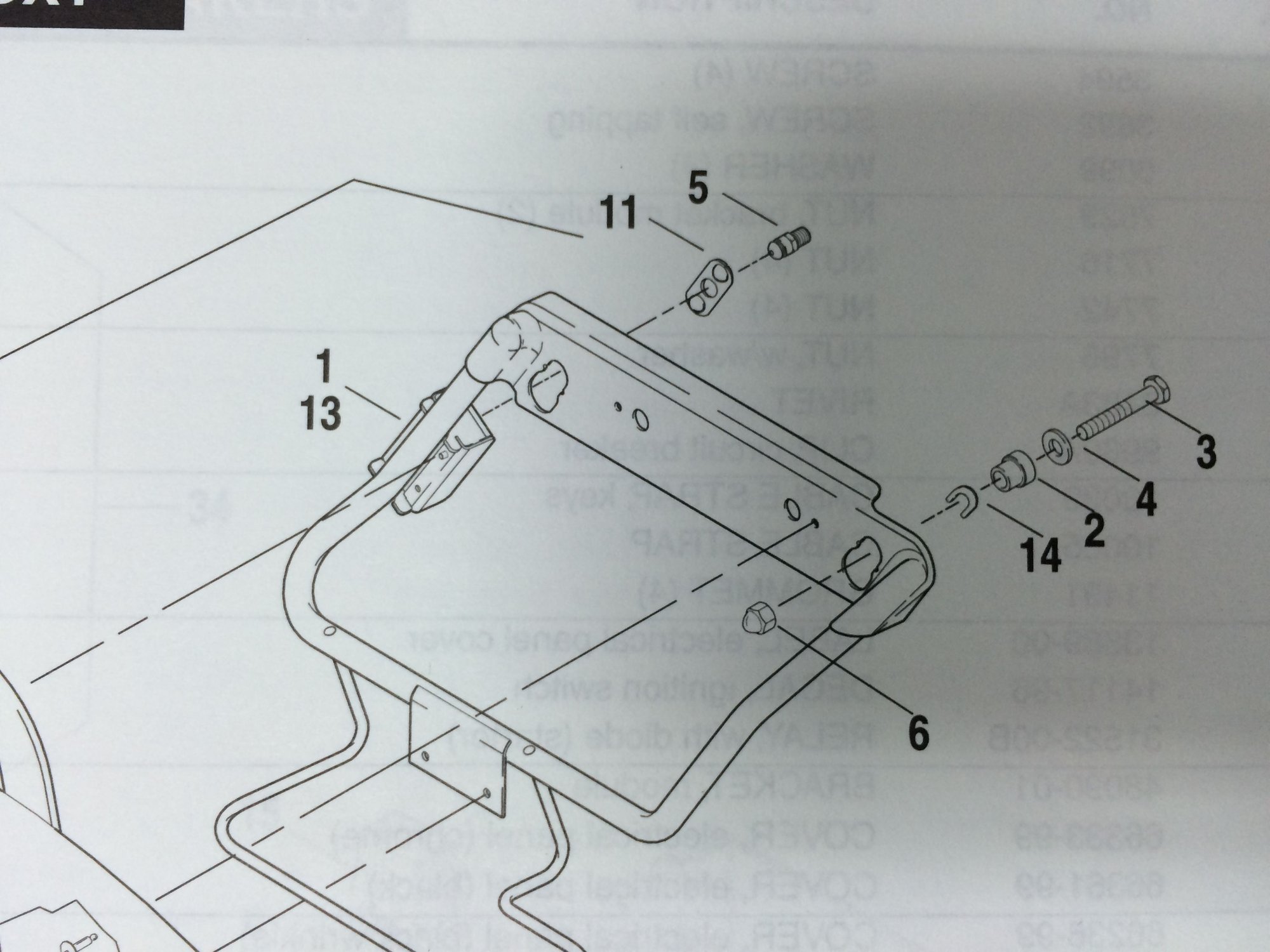

Hope these help. If you need part numbers let me know and I'll look them up for you.

Awesome. Thanks Jim. I have the bottom fender haner piece already in the fender. Its just the strut pieces that arent there. There is just bolts in the struts
Part #s would be amazing. As Harley by me says they cant find it and that its probably brcause they arr obsolete

You need 4 each of #2 - 4210
#3 - 3775
#4 - 6701
#6 - 7932
If you need anything else just let me know.
