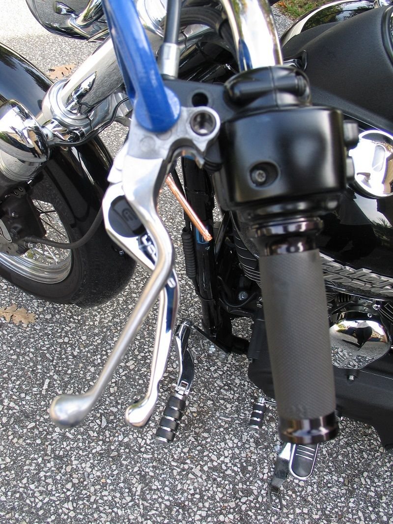

These are excellent quality and very precise. Here's a pic showing the stock lever clamped on top of the Oberon to show how much closer to the grip it can be.
