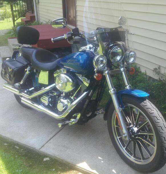

Just had foot surgery and need a heeltoe shifter for dyna low rider 2005. Harley shop couldn't find any but I seen one on a 2006 lowrider. Can anyone help me find where I can get one?

Thanks, that's looks like the one I seen. I have forward controls so I hope it will be a straight swap. Really like your bike! Sweet

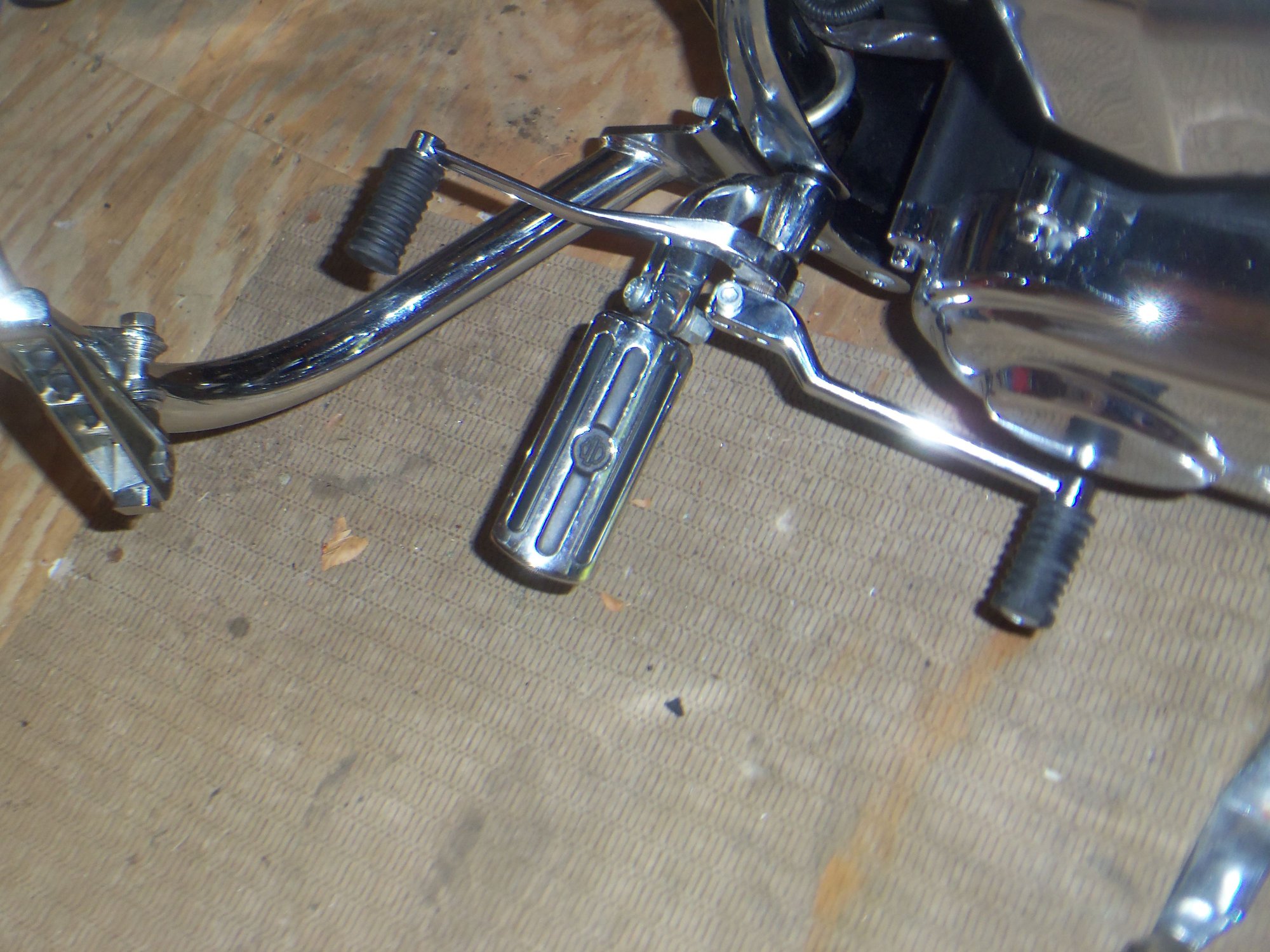

It will work with forwards - I had one, about $50 on Amazon. Had trouble reaching the rear shifter, but that's probably just me.Is this a temporary deal or are you going to use it all the time? There are threads describing how to "easily" fabricate a Touring/Softail type heel/toe shifter.

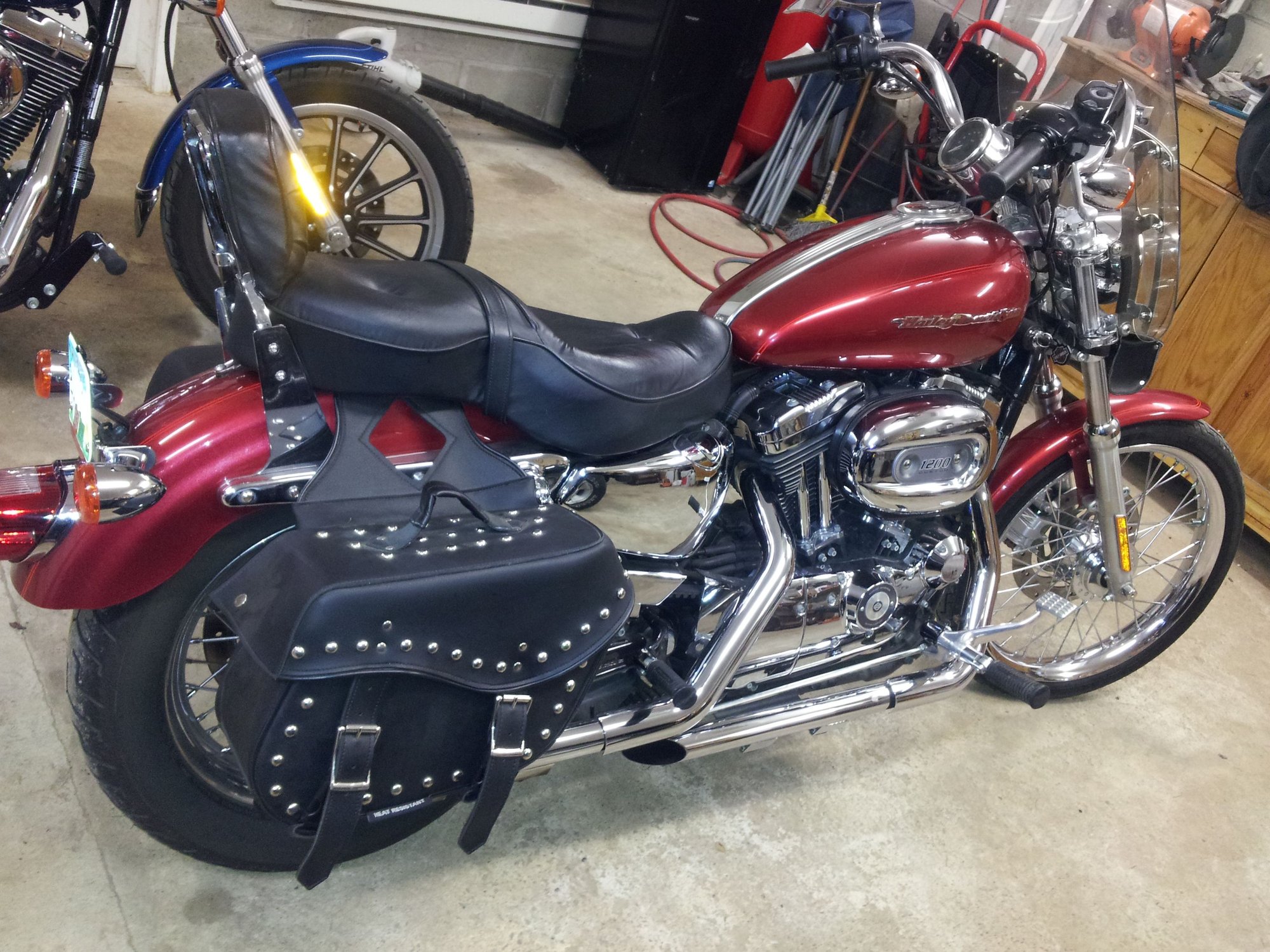

Yes I'm going to use it all the time. I ordered it from Hognutz for $48. Your bike is the one I first seen it on when I got on the forum. Couldn't pull it up on V-twin mfg under guest. Hope it works out alright. Looks really cool on your bike. I have a 05 sportster 1200 with forward controls also. I'm going to put it on it too if it works good on the lowrider. Thanks Sammi

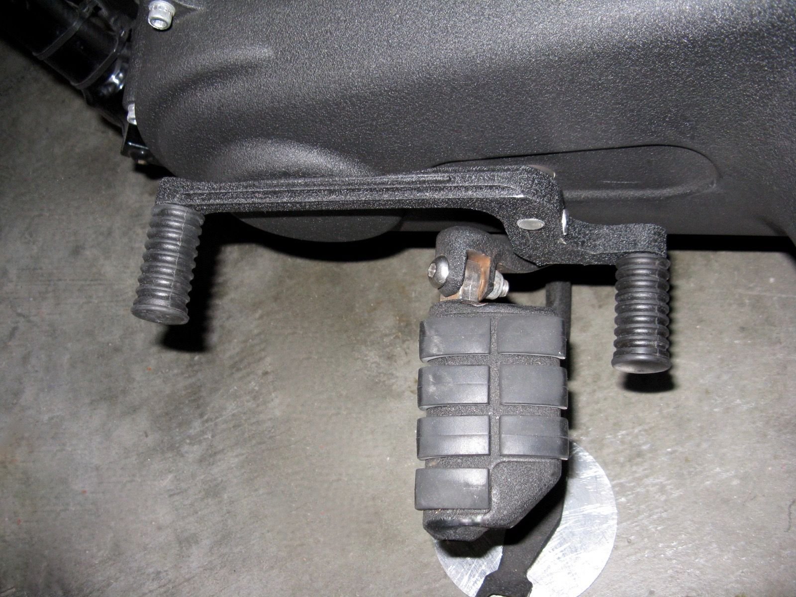

I went to this type heel/toe shifter in pic above because it's easier for me to use and adjust than the one piece shifter.
Here's the thread with instructions, post #30..He talks about a FLD but works on a Dyna with forwards. LMK if you have any quesions.

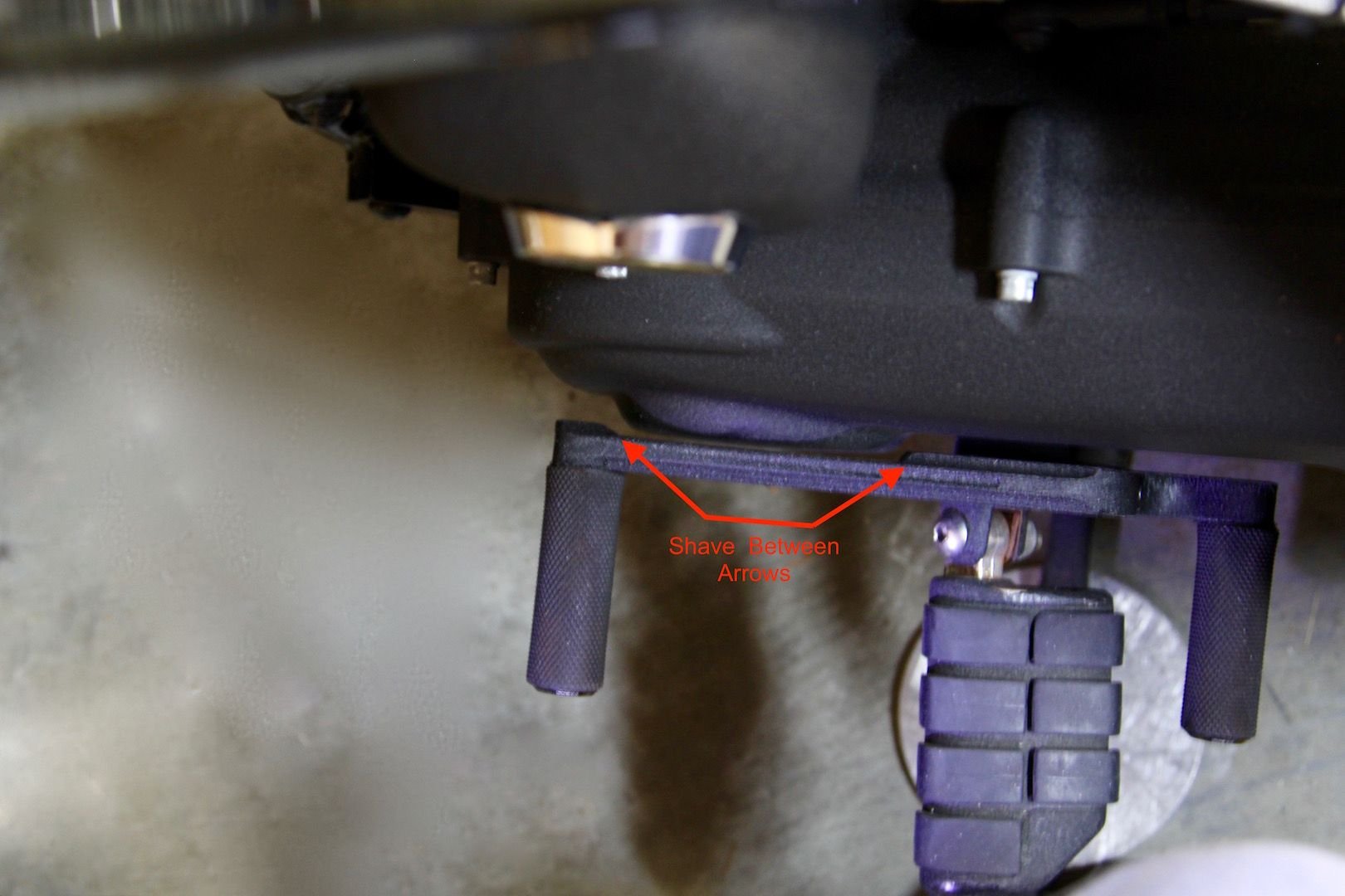

Couple of Dyna guys have used this shifter with forwards with no problems - search the forum for pics. If you are running mids like me, then you will have to shave off some material off the inside of the shifter to clear the primary (see pic). The biggest problem is that this shifter is very hard to find, and may actually be out of production. Good luck!

If finding one and milling backside down a bit easyer then making one at at
