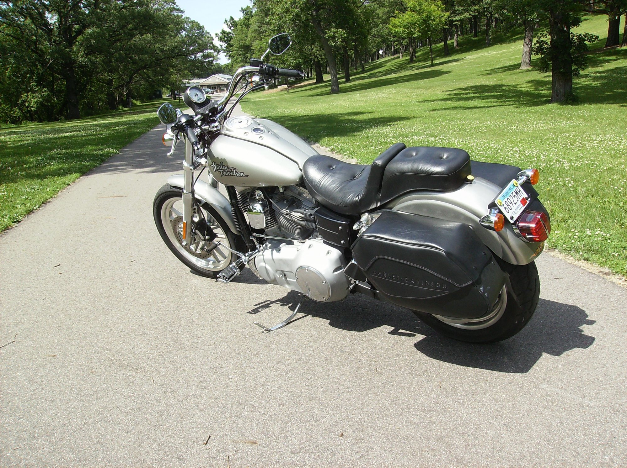

You could go like I did with the Kuryakyn kit 9063/9064 no disassembly at all,, there's a chrome cover for that shaft, you could paint it black,,
and Dennis Kirk has'm on sale right now.
Easy install, takes a few hours and your done.
https://www.denniskirk.com/search/20...kyn+forwards.q
