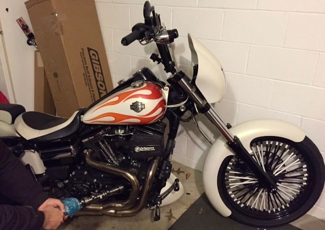

Robby, I was on the phone w/ fueling other day.... they do have brand new additions... they got ignition maps on their website. With the p.vision and the 574 cam. So if your indy can't get you in for a few check them out. They do have good tech and seem to really cater to the Vision, PC5, and TTS Master Tune.
ANYWAYS man... Great thread... no trolls, great pics, and people just talking Dynas. I like many others... are a huge fan of your build and the Reaper 574 cam.... but I was thinking of upgrading....
To a STAGE 3 Texas Speed Cam I purchased for my 2011 LS3 Camaro. LOL!
Just a tad BIG. Bummer!

Thank you so much I'll take a look. Your bike is killer by the way!
