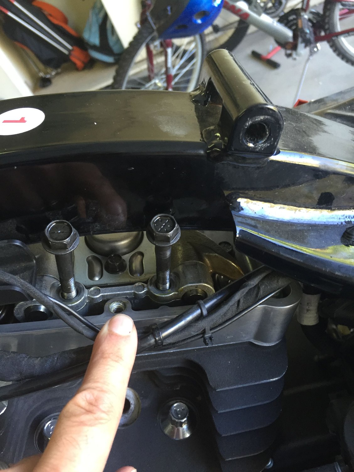

Spent a few hours today catching up. Got the breather assemblies replaced, rockers installed and heads buttoned up. Had a little scare when I found out the heads I have were touring models with motor mount holes on the front. No big deal in the end I'll just cover the holes and paint.
No pics taken but nothing out of the ordinary. Only main lesson learned is that when re-installing the rocker assemblies the rear cylinder ones need to have the bolts pre-installed, no room to fit them in with the backbone in the way so had to pull them out, put the bolts in and then install/tighten. Pic attached
