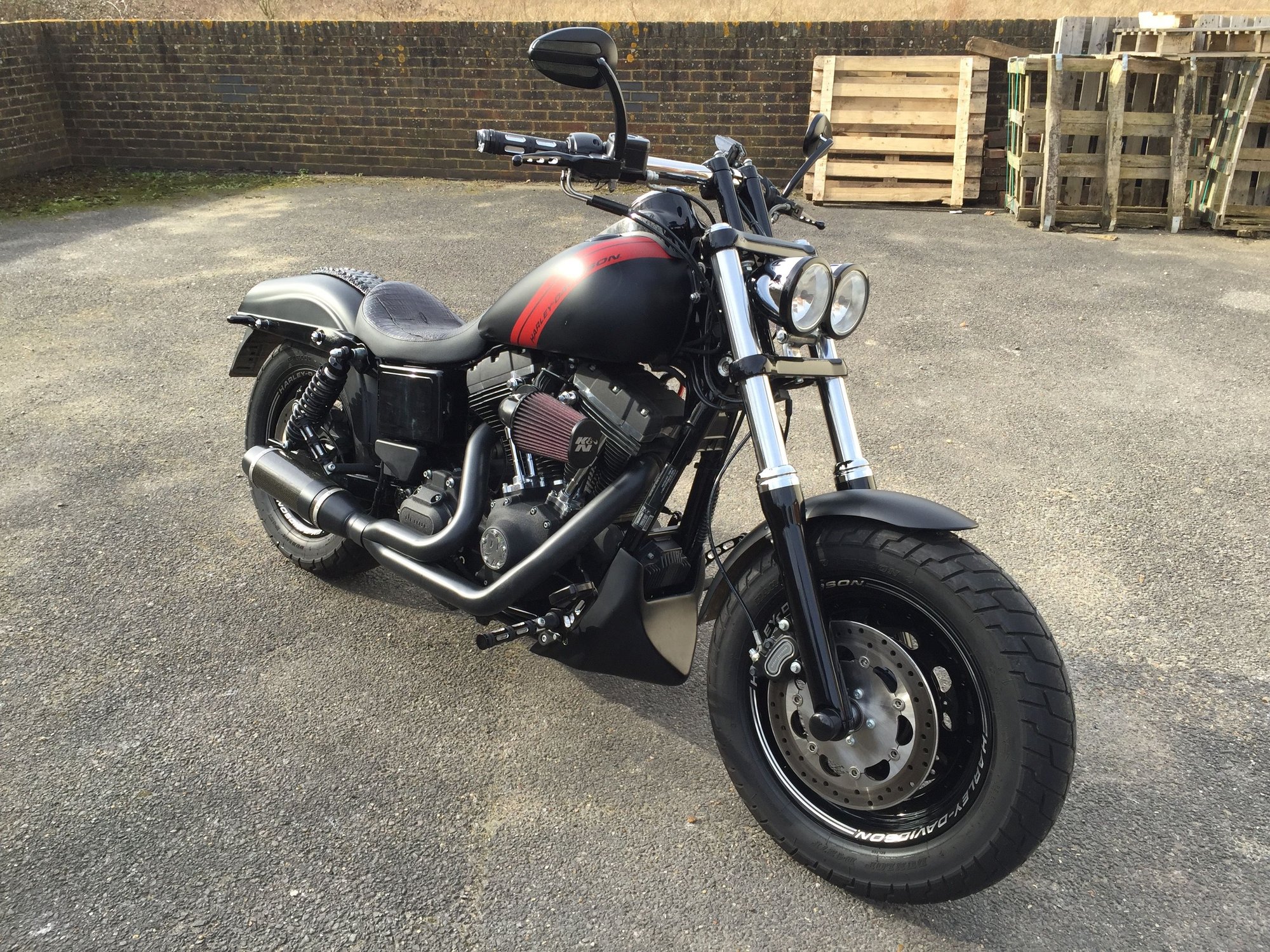

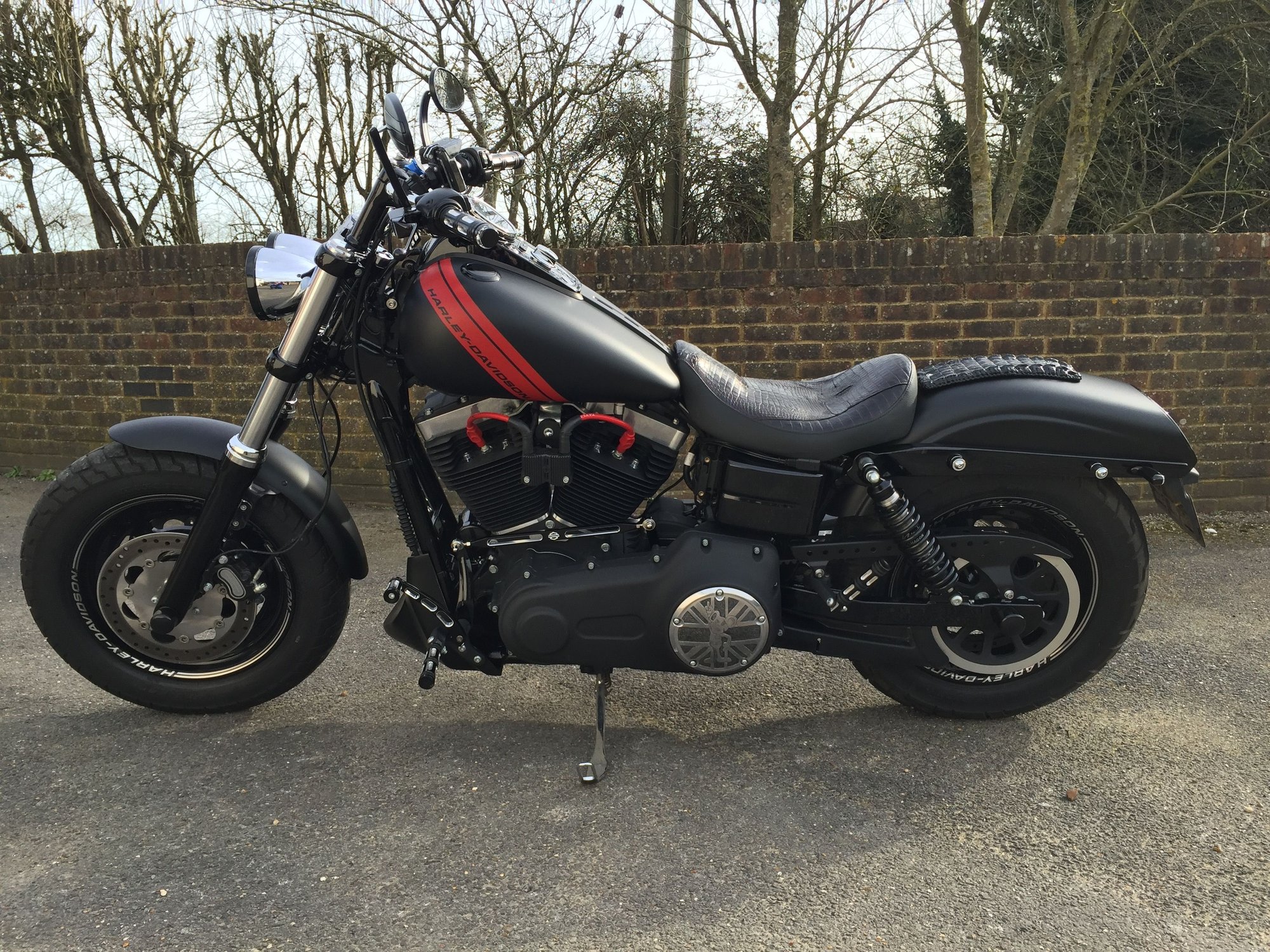

Here's a couple of gratuitous shots of the bike from earlier today....
