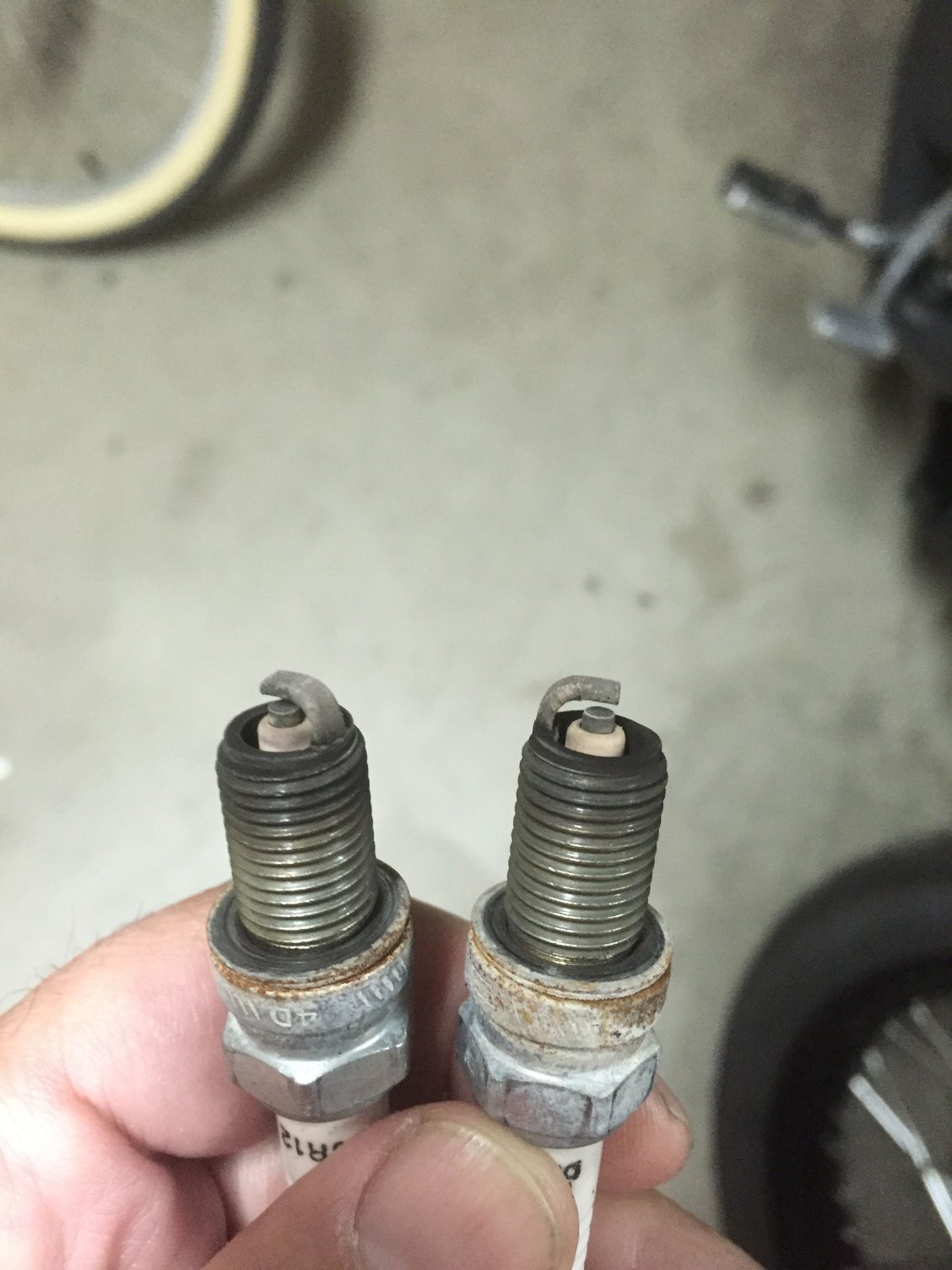

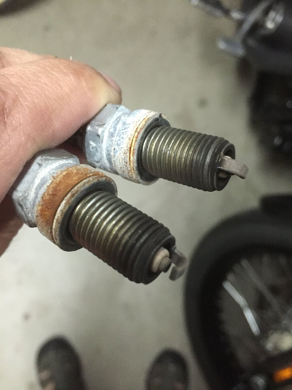

So I have about 100 miles on the current tune (still working on auto tune base map Andrews 57's with 2-1 exhaust, raised engine displacement by 10% and changed injectors to proper size).
Here is what the spark plugs look like, should I adjust anything in the VE or AFR tables immediately let the autotune keep going for now?
Old Feb 28, 2016 | 10:24 AM
  #180
mattVA's Avatar
mattVA
Joined: May 2009
Posts: 2,066
Likes: 97
From: Northern VA
Keep on trucking nice light tan.
