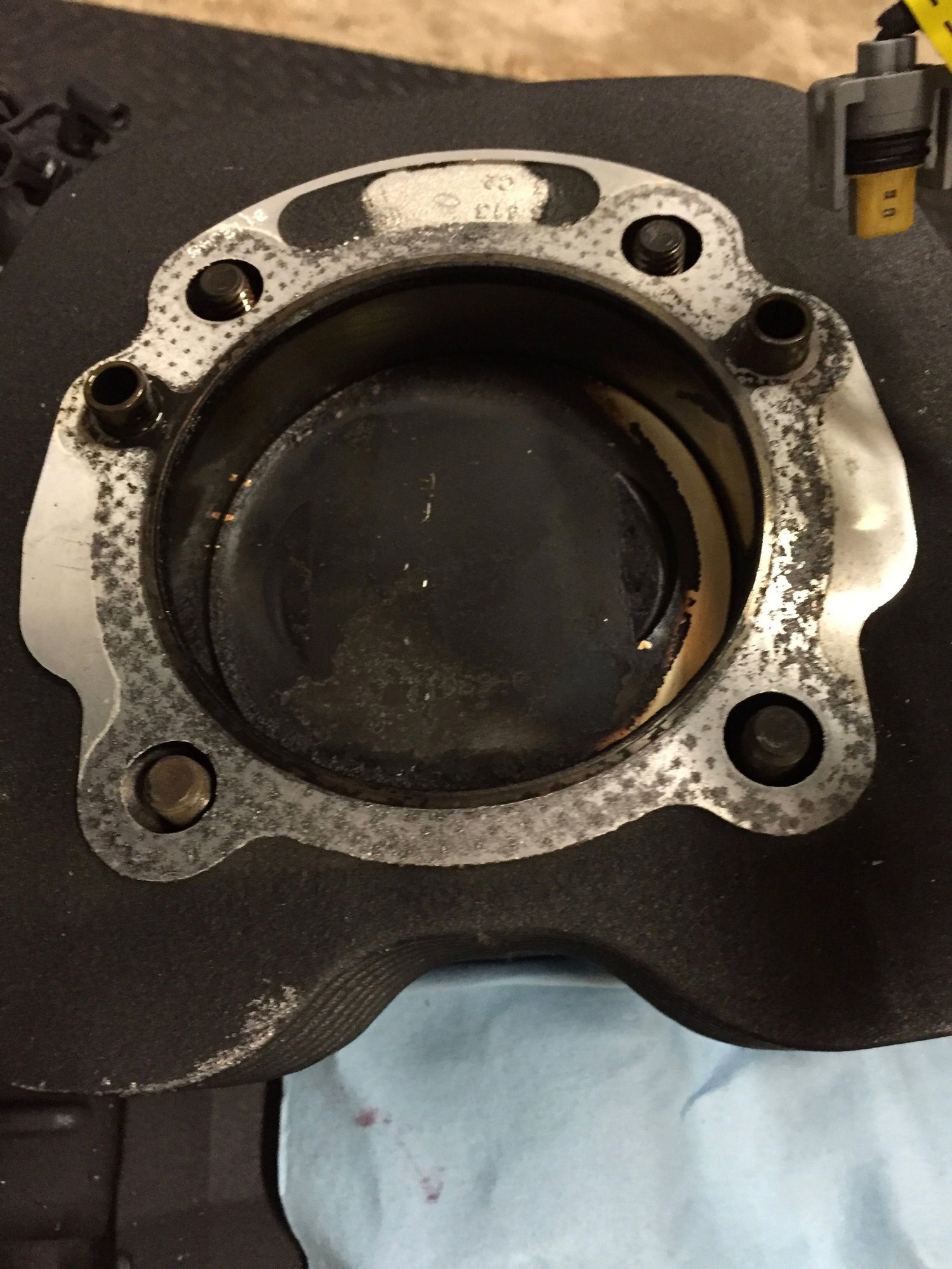

Originally Posted by adm
Here's what mine looked like before and after.....I tried various solvents and got nowhere fast. In the end I used very fine Scotchbrite and plastic razor blades.
One tip if you do it this way is to bring the piston to TDC, and smear some grease between the cylinder and the piston to prevent any debris getting down to the rings. When you bring the piston down again, any leftover crap is stuck in the grease at the top of the cylinder.
neat job adm
