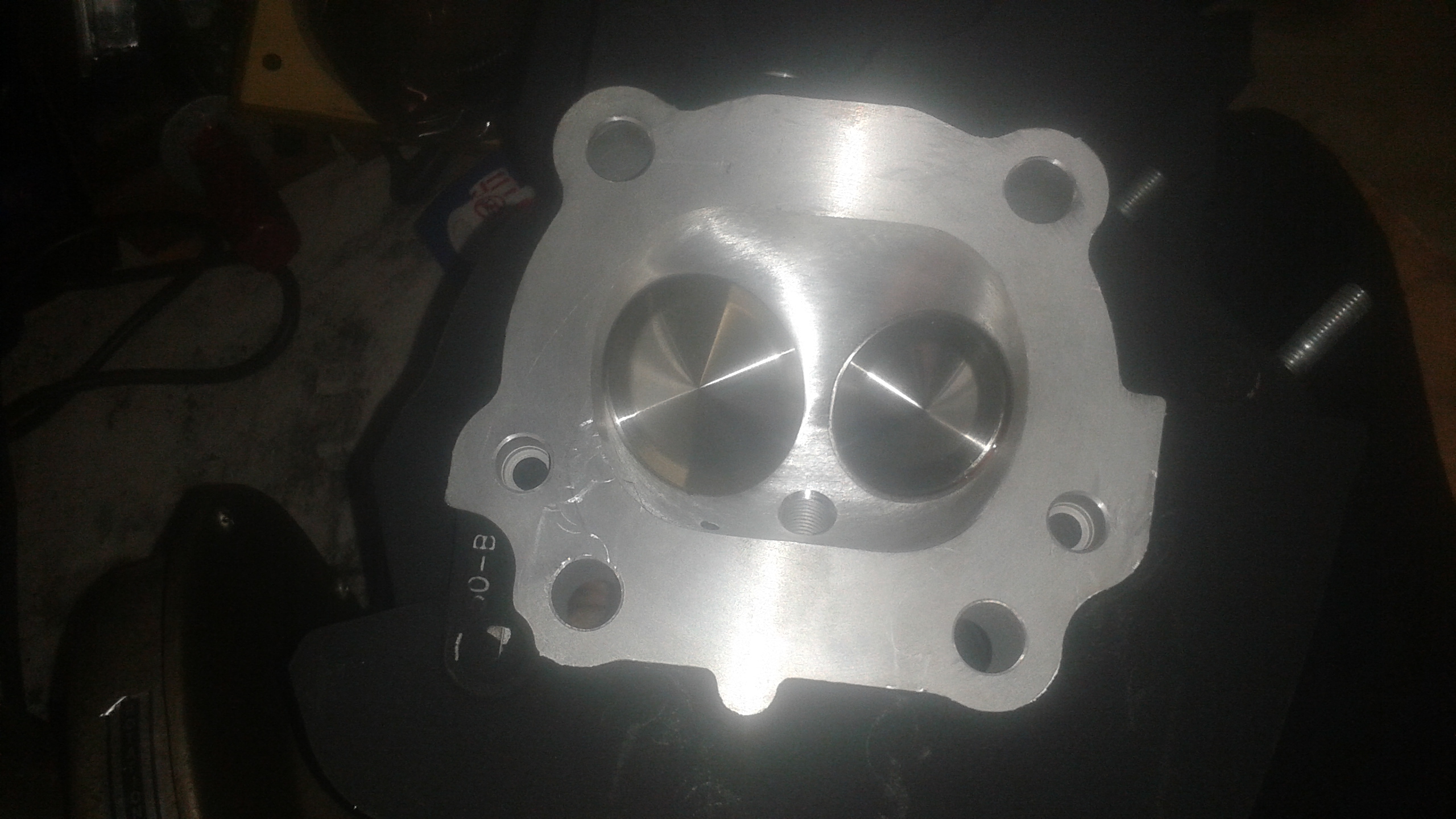

Wow nice the transition on the in side of the head looks sweet with the big valves new spring.

Default Your is bigger than mine
Took so shot of mine the difference between them dammmmit and still waiting for my crankcase and crank to be trued and welded

Are you kidding, they look great as well! Are those the SE's?
