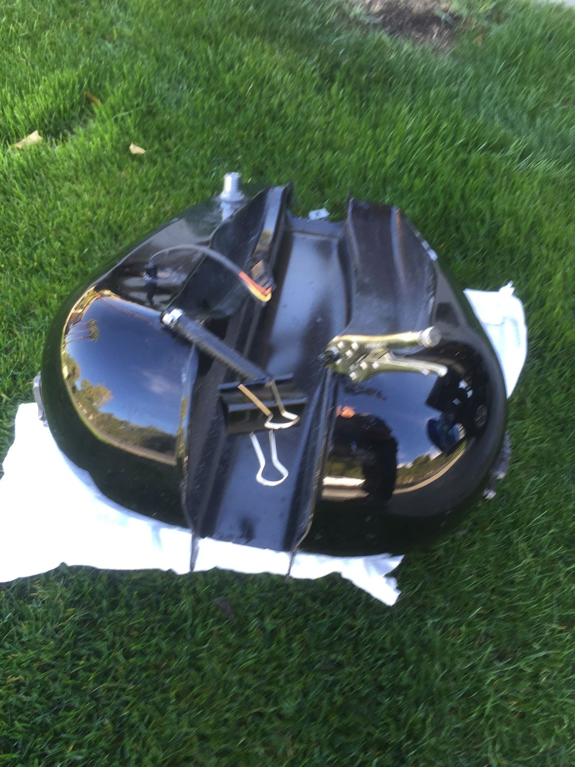

Tank was ok, I was nervous about cutting the crossover line. One of my clamps didn't work so well and as a result I had to sit there holding my fuel can under the cut line. Overall not so bad.

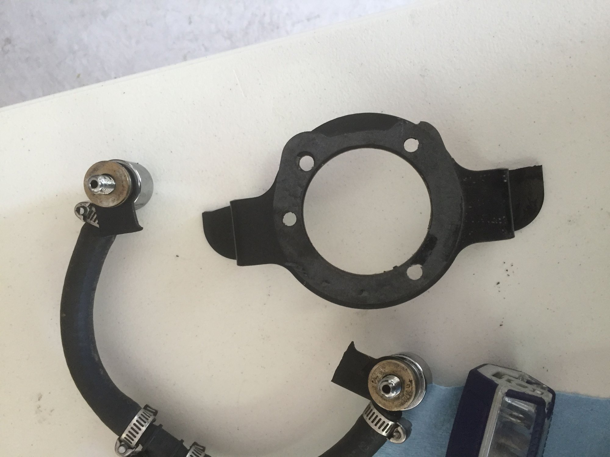

Another problem was that my air cleaner back plate was broken on both sides. Will call DK Customs on Monday to see if they can send another.

Tank off, need to get the old hose off and drain the other side. I had less than a gallon in there.
Broken back plate in my DK Custom and discreet breather. Must have been excessive vibration or too tight

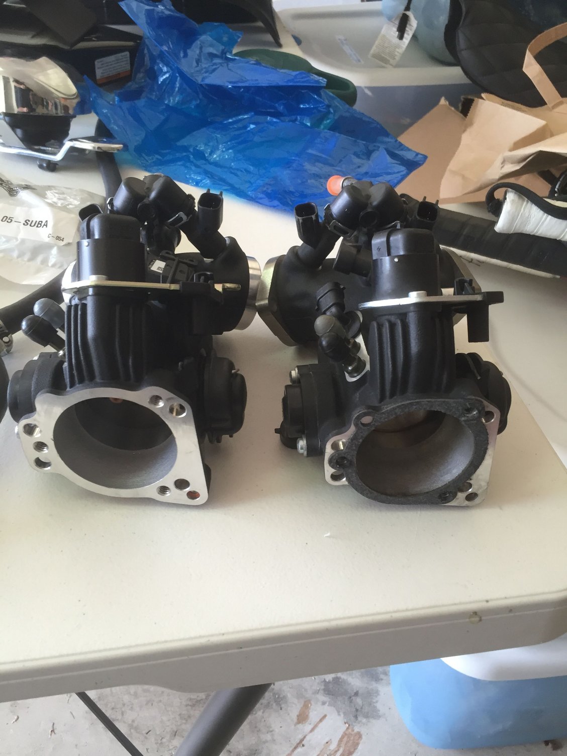

The throttle body wasn't as hard to get off as I thought it might be, but really tough unplugging all the connectors with my stubby fingers. I wonder if it would be easier to plug everything back on before I replace the rocker covers?

New throttle body on the left. SE 50mm with 4.9 injectors I believe

Robby - a Dymo label thingy is your friend. However - on the throttle body connectors, they are all different so you actually can't put it back together the wrong way....
On the crossover, you will probably take the tank off several times while doing this job and being happy with putting it back together.....plus you may also want to take the tank off many times during your ownership of the bike. So my advice would be to install a quick disconnect coupling to make that much easier.
One word of caution though. I bought a cheap plastic one and it leaked like a bastard. I would have bought a decent metal one, but can't seem to get them here in the UK.
I ended up just removing the metal clamps from the crossover and pulling one end off while sticking 3/8" ID (i think) silicon tube over the free spigot and the other end of the crossover and running those to a fuel container. Works fine and easier than cutting and clamping. Then when I re-fit the crossover, I just tighten it up with heavy duty cable ties pulled really tight with a wrench. When you want to get it off again, just cut the block off the cable tie and wriggle it loose.

Looking good Robby! Sucks about the intake let us know what dk says. I wouldn't worry about the tb plugs, they'll kind of naturally fall back where they were and like it was mentioned, each plug is different, just don't forget any of them. Those quick disconnects have a habit of leaking but that metal one looks to be better quality then I've seen before. If it were me I'd get a new piece of hose and a couple clean clamps and just put it back together. It's not a huge deal to drain the gas to pull the tank, you get better at it the more you pull it. The key is having it as empty as possible

The front and rear cyl. fuel injector plugs are identical so make sure you know what one goes where.
