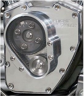

It looks good but I've heard there are problems with those and Figure Machine makes crappy parts.. Didn't experience it first hand though
really? i need to scour reviews then. i'd rather have the figure machine cover than the rsd cover. the rsd blocks the things we want to see.
i'm going to try the derby first but, the gasket will be an issue i think. where will i get replacements later on? the stock moco gasket5 would block the window. we'd just see "this side out"

I think you are asking for leaks with those clarity covers. Check reviews.
It's not a big deal to check the tensioner shoes normally.

goodness. the touring folks seem to have been all over this stuff:
https://www.hdforums.com/forum/touri...y-cover-3.html
found others too:
http://www.retrocycle.com/CustomChro...rby_Cover.html
http://www.barnettclutches.com/all-n...by-covers.html
found all kindas stuff:
https://www.google.com/search?q=clea...cover%20harley
most notable-

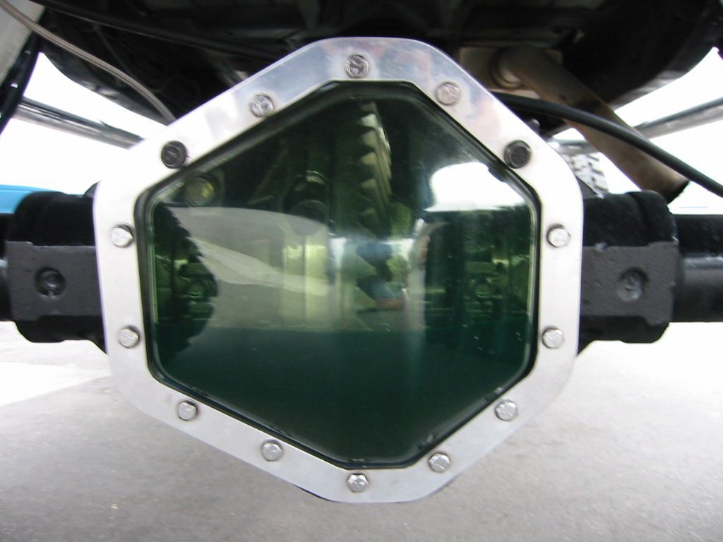

wtf? the stones it must take to run this on your truck/jeep

Since someone didn't use the right key words in his search I found this for him.
Edit: Not sure if I can post that link, so here's a paraphrase of the review.
Comments about Roland Sands Design Clarity Rocker Box Covers:
I have three clarity covers installed on my 2013 Harley Softail slim. Derby, Cam and Rocker Box. All installed by an authorized Harley Davidson dealership mechanic. Each one is cracked and leaking oil. Performance Machine is unable to send me replacement parts on the Rocker Boxes because they don't have the parts. What does this say about the quality of Roland Sands and the warranty? Serious safety and customer service issue! Roland, I hope you are listening...
BOTTOM LINE No, I would not recommend this to a friend
Was this review helpful? Yes / No - You may also flag this review

there are issues in that review and it is covering rsd's goods. i learned long ago to look closely at reviews because logic is not always used in them. i have seen some of the most insane reviews with low ratings for products that make absolutely no sense. i've really been unable to find reviews for figure machines stuff
i'm not interested in anything RSD. i outright refuse to put RSD on my bike just on principle, lol.
the softail and touring folks are using the windowed stuff with no issues.
https://www.hdforums.com/forum/softa...rby-cover.html
i spoke to this guy and he's had no issues.

understood and i totally feel that way about a lot of things i see people slapping on their bikes. i'm just nervous about the random failures. the S&S is a must. the cover will let me stalk the shoe until 20k

Have had RS covers for years, not a single leak or problem. Folks like looking at the S & S gear drive and lockup clutch. No whine or fuss.
