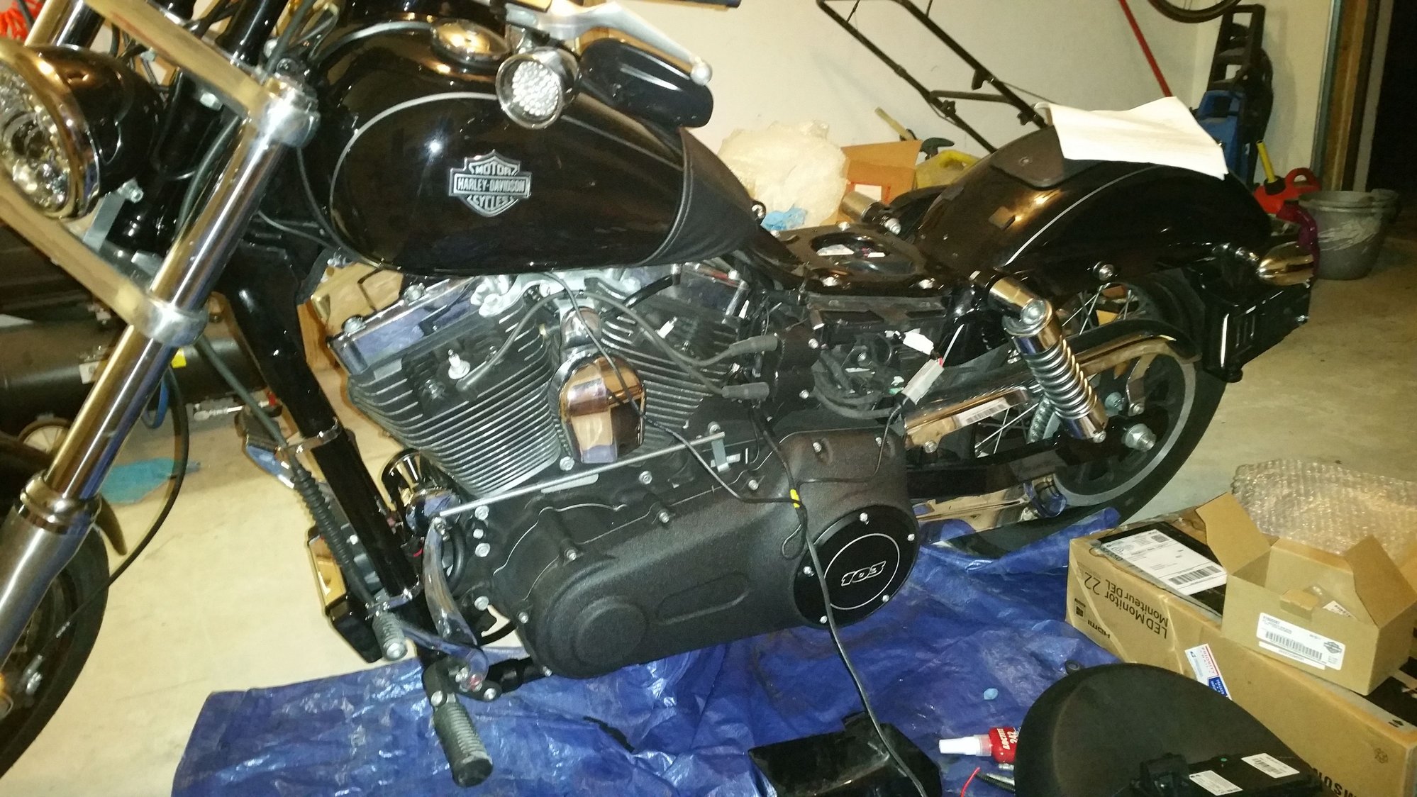

Default great big mess and ness: primary cover replacement, clutch adjustment, derby swap, oil cooler wire reroute, alarm install....stupidity
Parts used:
ebayed wrinkle black primary outer cover
Cometic PRIMARY GASKET hd-60547-06 ; cometic (C09145F5)
derby cover donated by modular earlier in the thread. (thank you!)

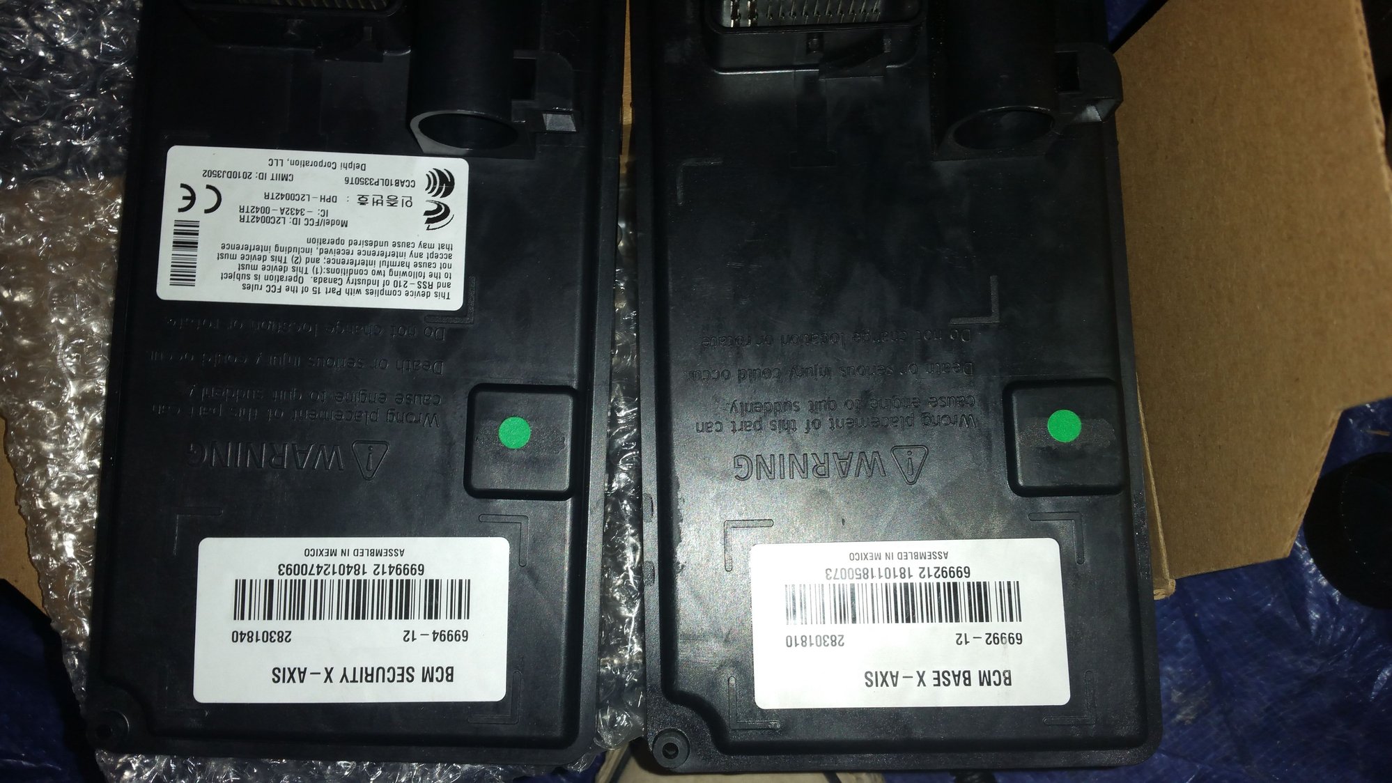

Smart Security System-41000087
ness kits showed up:
dropping them off for powder in the morning

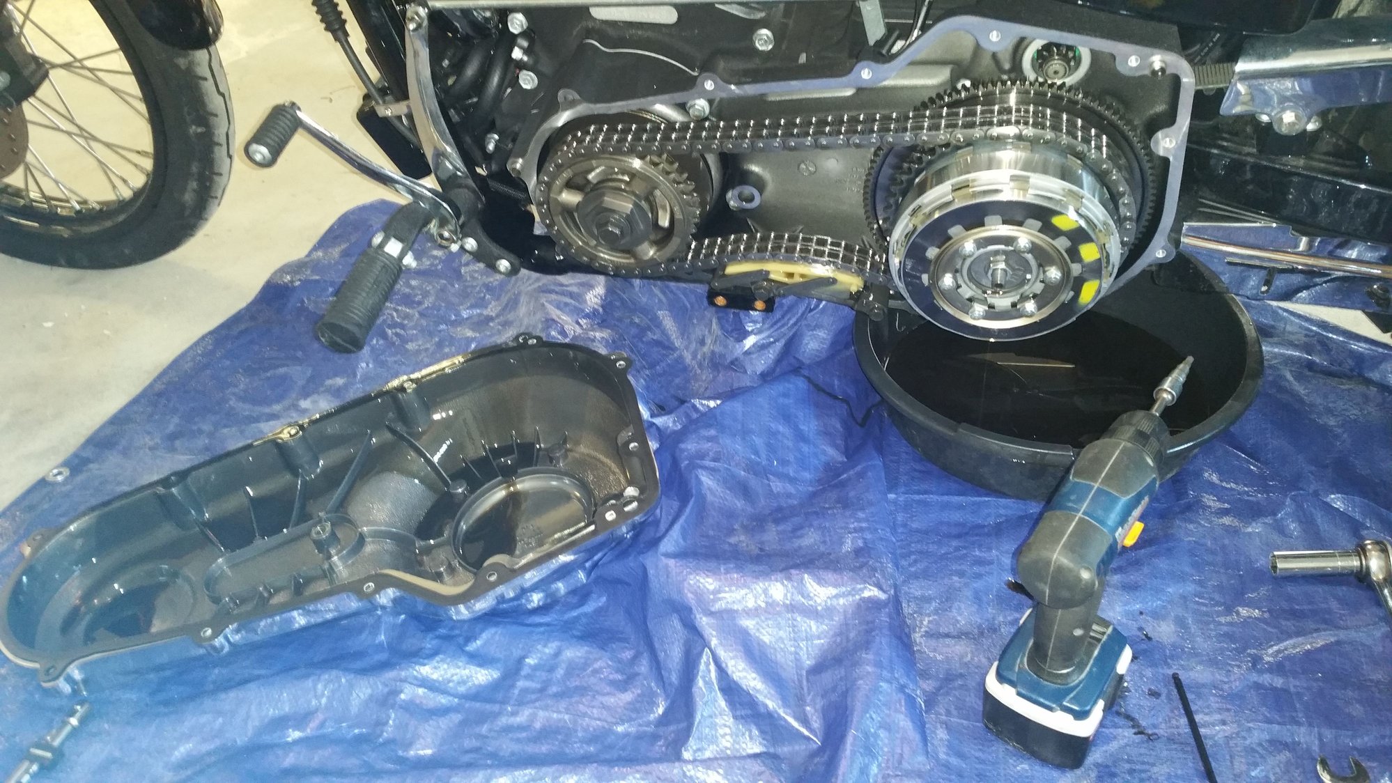

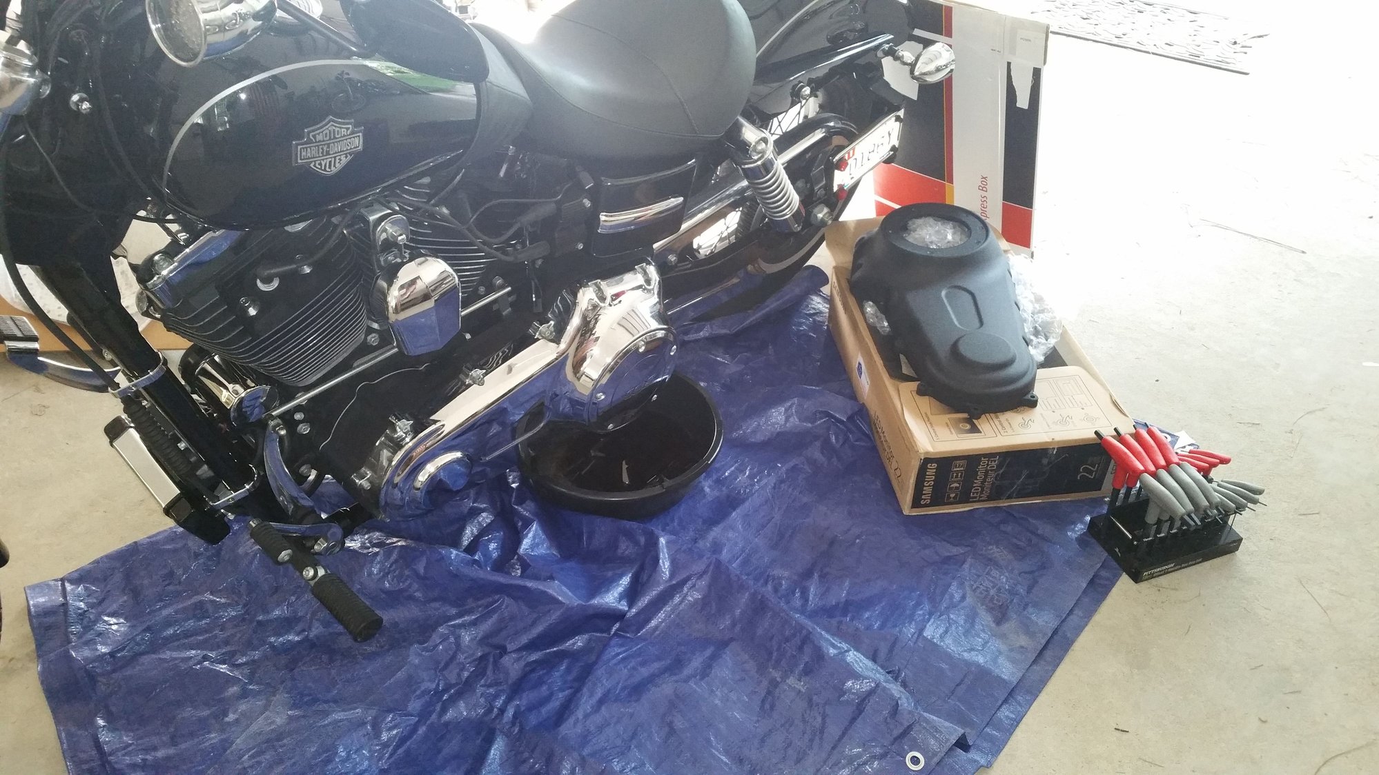

swapped away that dang chrome primary cover:
evil chrome primary- draining the fluid
freed the cover and burned the boats...
adjusted the clutch (knocking out 5k service)
learned this from watch you forum folks..
new gasket
big ole mess... done though buttoned up... 12ft-lbs all around... mdular's derby installed

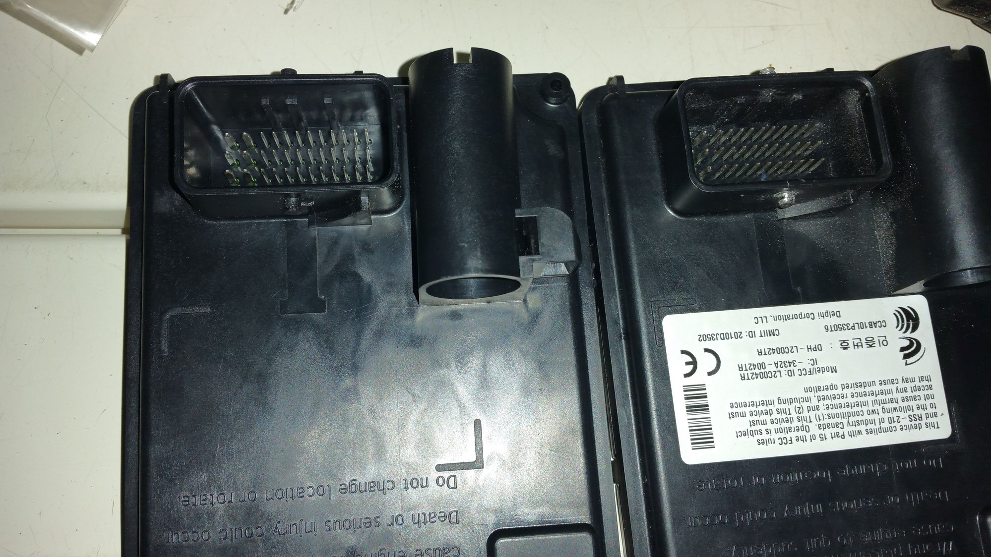

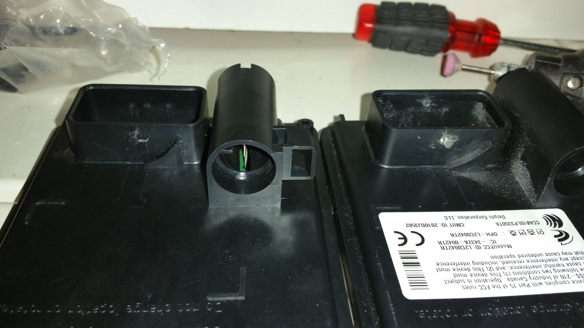

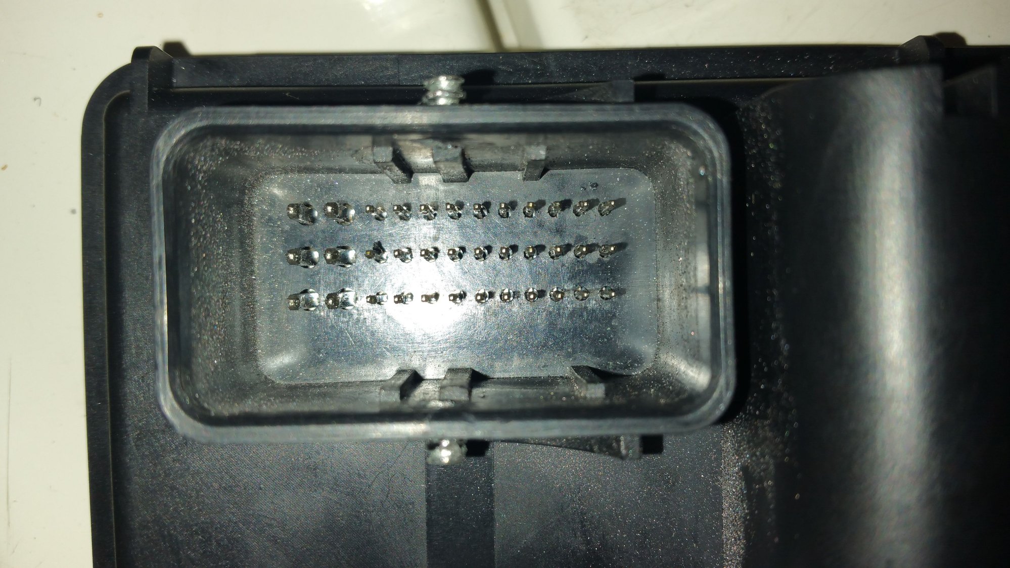

added in the alarm module and antenna... siren is in the mail somewhere.... rerouted the oil cooler fan
rerouted the oil cooler fan- same as before:
https://www.hdforums.com/forum/dyna-...l#post14691077
install to easy to cover but, i did manage to fk it up some how... the little ears popped of the delphi connector on the new module.... had to drill out the area and create studs from tiny screws... fixed. then forgot that i had unplugged the spark cables to avoid a start... could figured out why the bike refused to start.... dumb a**
no idea how i f'd it up.... but, fixed.
quit for the day... will program and install foot pegs tomorrow

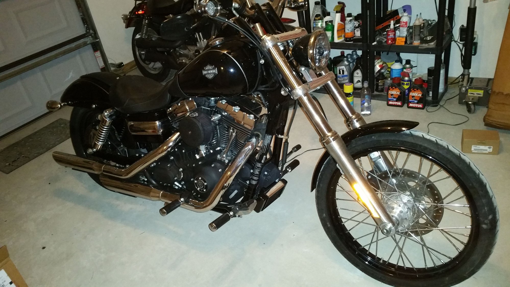

Coming along nicely.

Too late at this point but if I'd have realized you were going to change out the cover so quickly I would have suggested replacing the shoddy auto primary chain tensioner with a nice Baker Attitude manual tensioner while you had the primary cover off...
We'll get it next time

Originally Posted by TinCupChalice
Nicely done!
yeah i remembered it while i was looking at the guts... but, it's not hard getting that cover off and on, i would just need a new gasket when i go back in. i was dreading it but, getting that cover off/on was the easiest thing i did yesterday. what was scarey was the super low amount of fluid that came out... no bueno... glad i addressed it

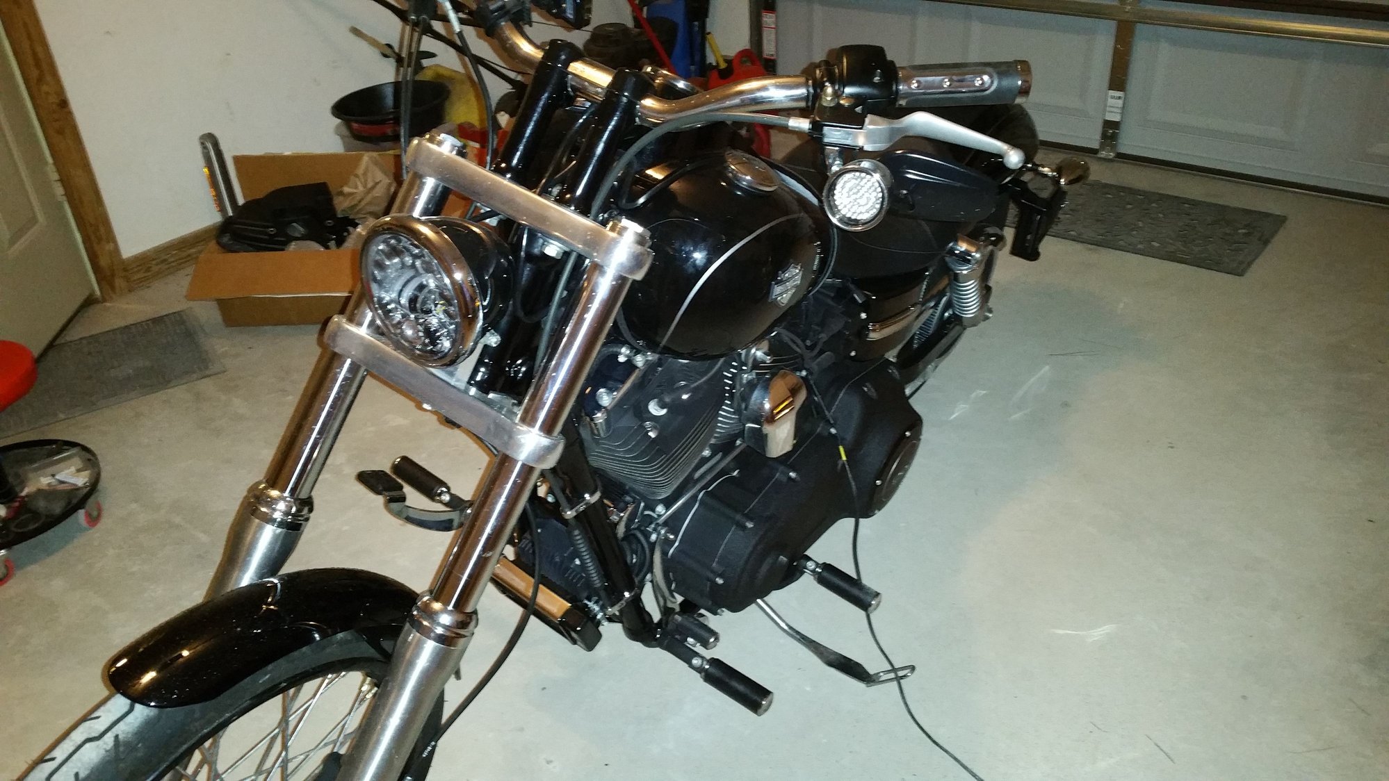

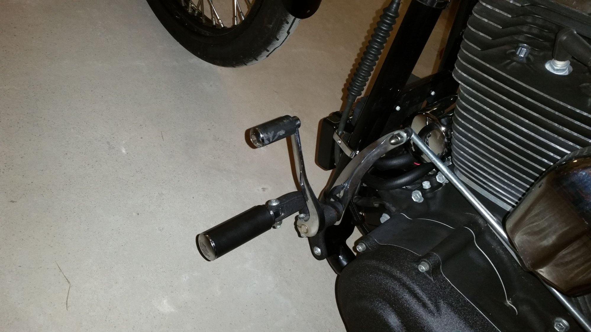

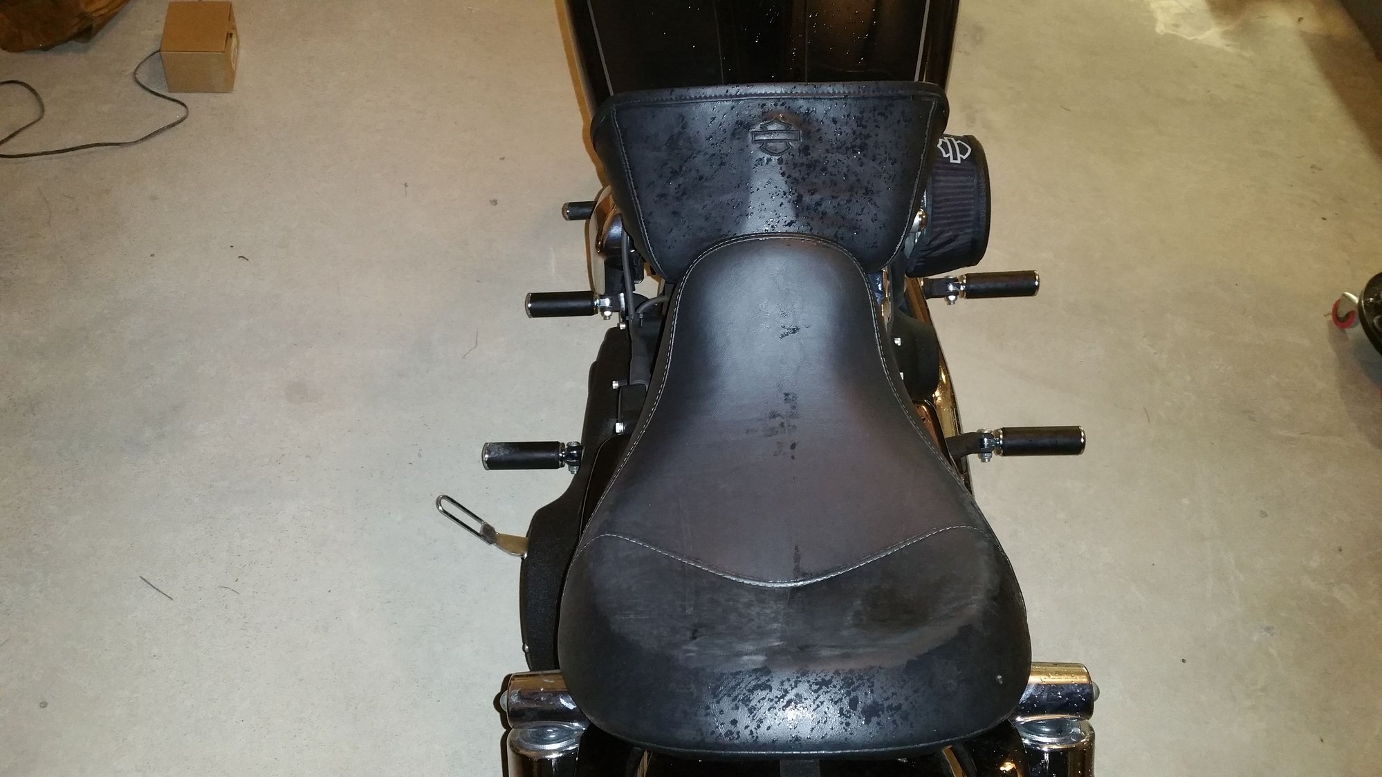

Parts used:
  • 91821-85 CUSHION FOOTPEG KIT,SMALL
  • random, semi match shift peg from my bucket-o-parts
  • white stripes - elephant
same as before: https://www.hdforums.com/forum/dyna-...l#post14648516
just with the super loctite bottle... fuggin love it.
Mounts and pegs added

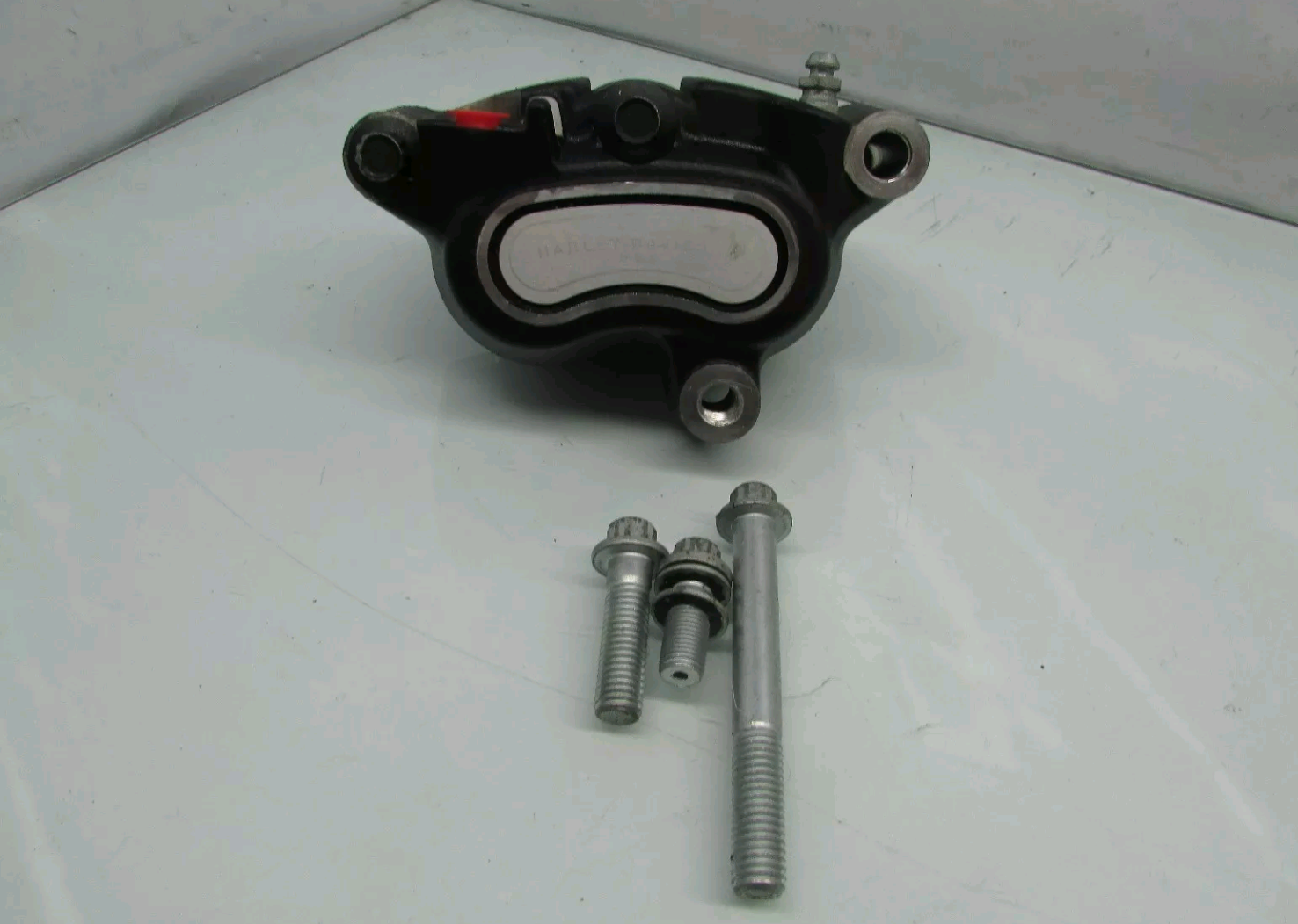

Default Found right side caliper
The wizard, Multihdrdr, found a right side caliper that needs love on ebay .
Bought it and some more lyndall pads
Forum dividends and good folks!
