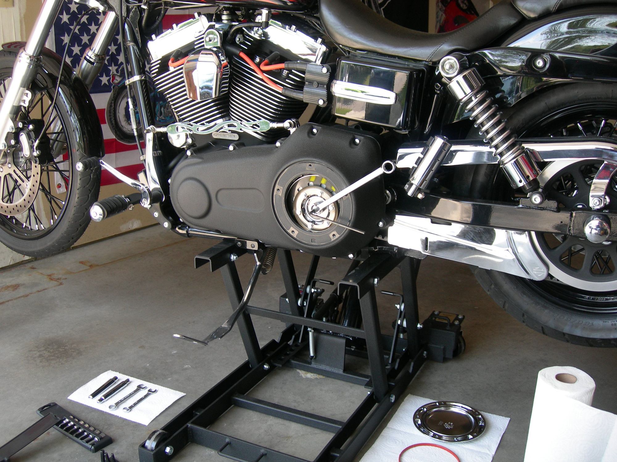

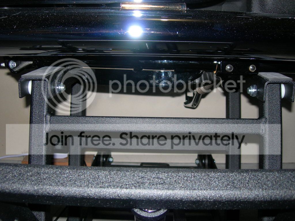

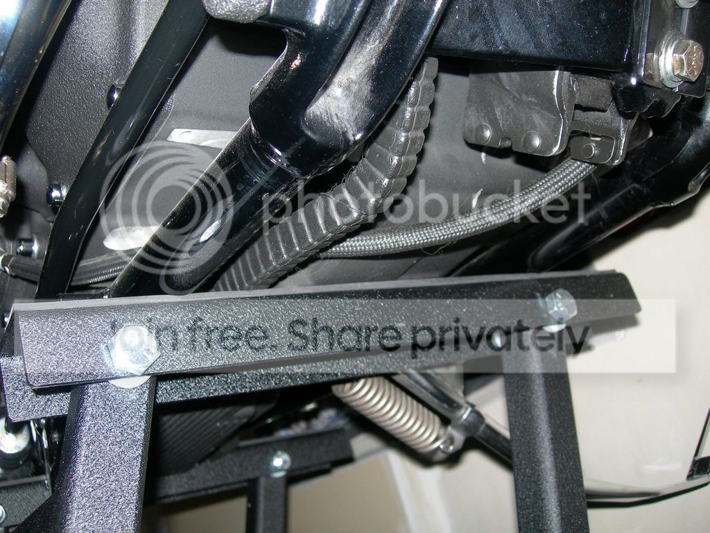

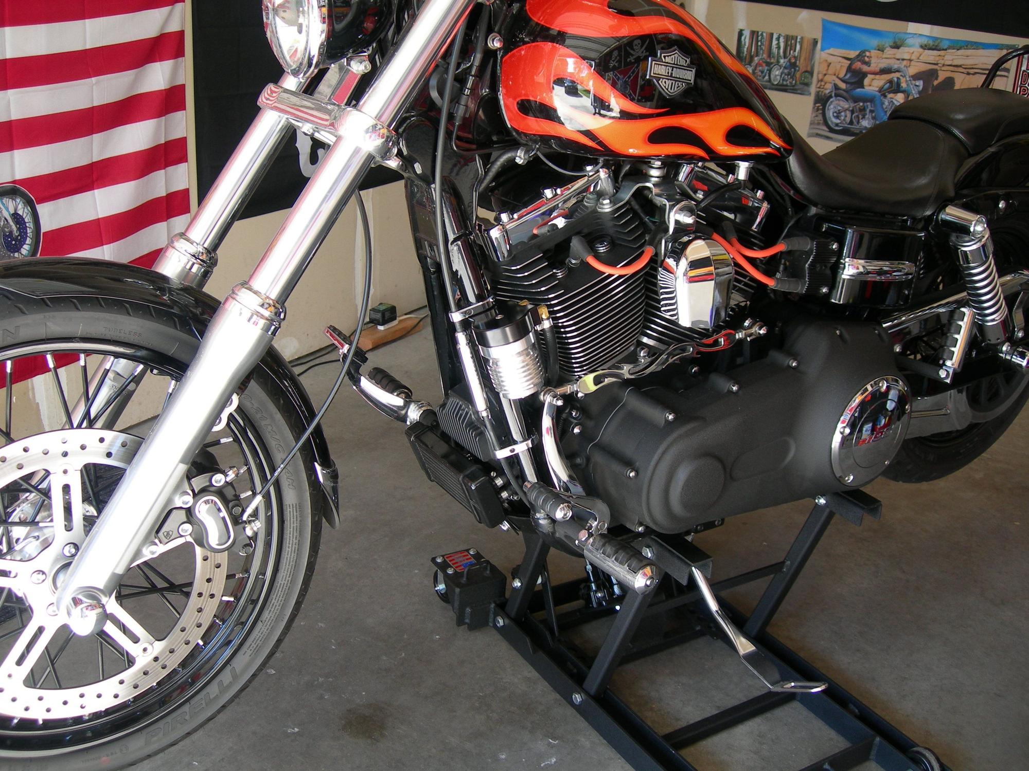

Originally Posted by Gearhead88
Thank's for the pictures , The position of the two channels appear to be an ideal width for a dyna.
The J&S does fit the Dyna frame nicely; with the Dyna having basically only one way to position the J&S about the only concern I'd have is if I were to be stripping down the rolling chassis to the frame and the engine/transmission/primary in the frame. As you pull the weight from the bike I'd suspect she'd get nose heavy on the lift due to the front lift arm being directly between the cylinders. If I start stripping her down that far, there will be some straps on her then

On a Dyna when you've positioned the J&S so the rear lift arm is behind the frame protector and pan you'll have plenty of clearance between the lift arms and the primary; I don't see how the primary and lift arm could contact each other...
