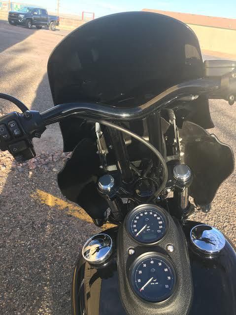

I ran 12" and used Fat Bob ABS +6 and +6 clutch on mine. My clutch cable is a bit long, but then again your bars will have a little extra pull back. +5 will work, if you are willing to risk it, maybe a +4 clutch and a +5 brake. Here is a pic of mine that I just walked out and took. You can see the clutch cable looks wonky. I've often thought of buying a +4 just to see if it will work to clean things up. The brake line is a perfect fit.
