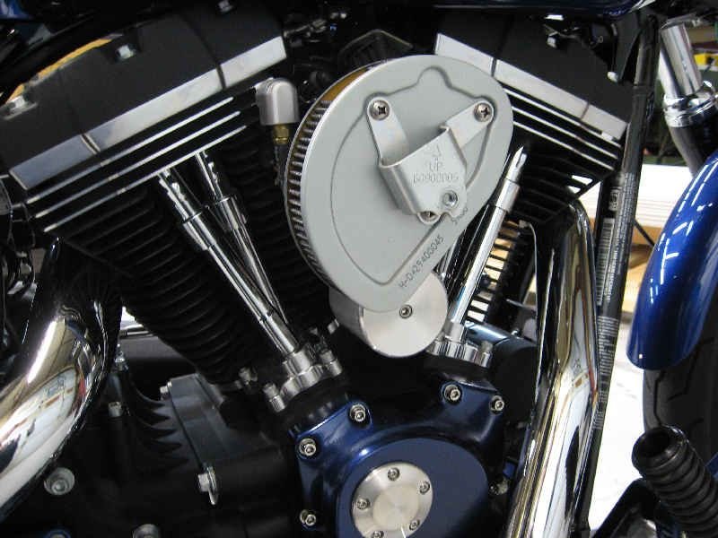

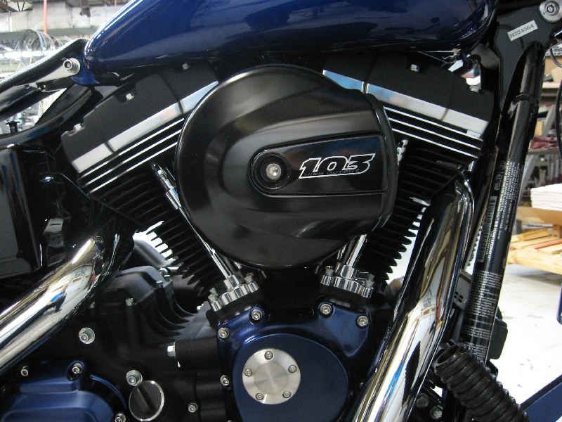

Routing that hot oily air externally with an External Breather System rather than back into your engine is definitely something you'll want to do to prolong engine life AND increase performance.
Check out these images....
Now, when it comes to blow by, if you have blow by in excess, you'll not want to go with the breather bolts. There will be a mess down the side of your bike and if you have a passenger, they won't be too pleased either, lol.
If this is your case, there are options, however, for hose and filter or catch can External Breather Systems. Allows you to route the filter/catch can basically anywhere on your bike in case you'd prefer to have it sort of hidden.
But to your main question, I would not suggest leaving it as is. Do your bike a favor and route externally. I assure you, you will be glad you've done so and so will your engine. Engines prefer and run better on cool, clean, air.
Click this LINK to see our Twin Cam External Breather Systems.
Also, the link below contains lots of information pertaining to this that you may find helpful.
https://www.hdforums.com/forum/oil-a...f-my-bike.html

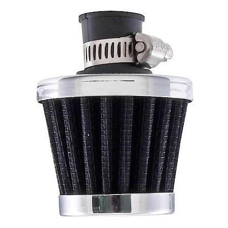

4 hose clamps, about a foot of hose, a brass T hose fitting, and one of these...around $20 total.
