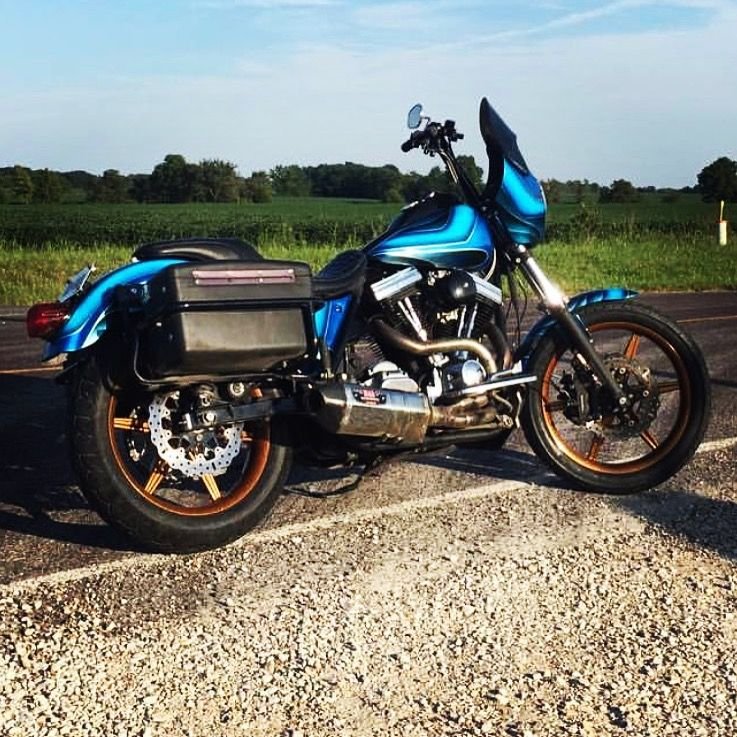

Don’t know for sure yet. Sent Scott some photos of the bike and asked him to come up with some ideas for it. I’m definitely not an artist, so I figure let the people who know what they are doing, do it.
I did tell him I wanted to stick with a black base color. I’m thinking maybe something like this he did, but with blacks, grays and silvers:
He’s done quite a few of my brother’s bikes including his FXRP and 1940 Knuckle. Scott can do pretty much any style paint job and absolutely kill it!
My brother’s bikes:
