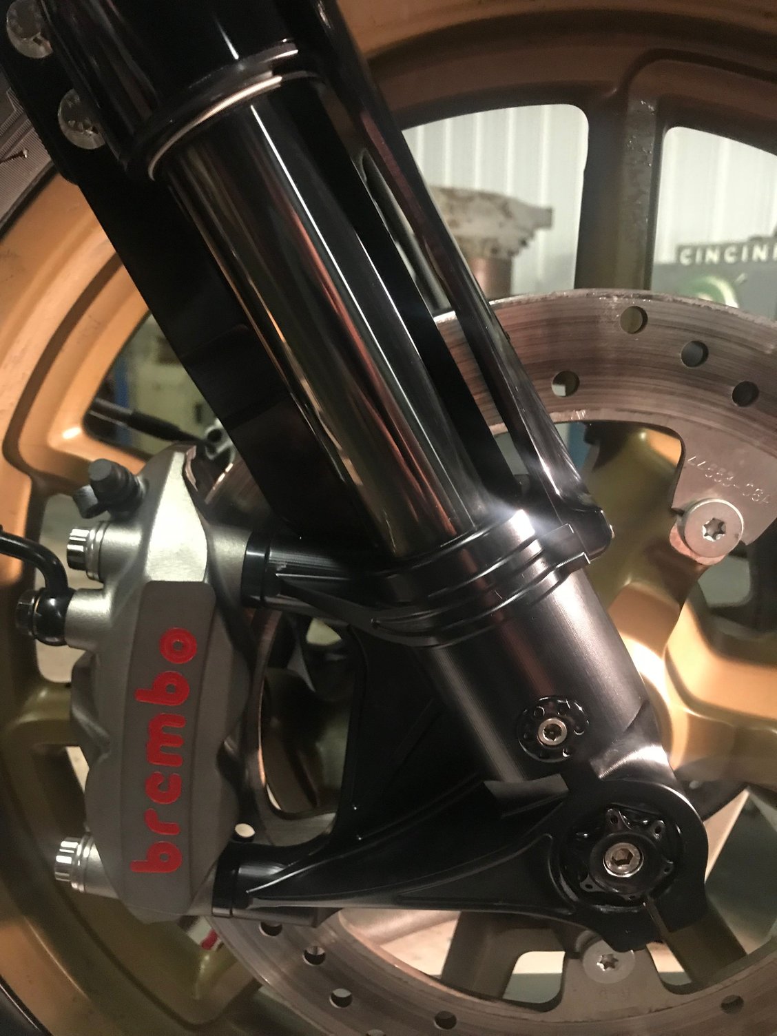

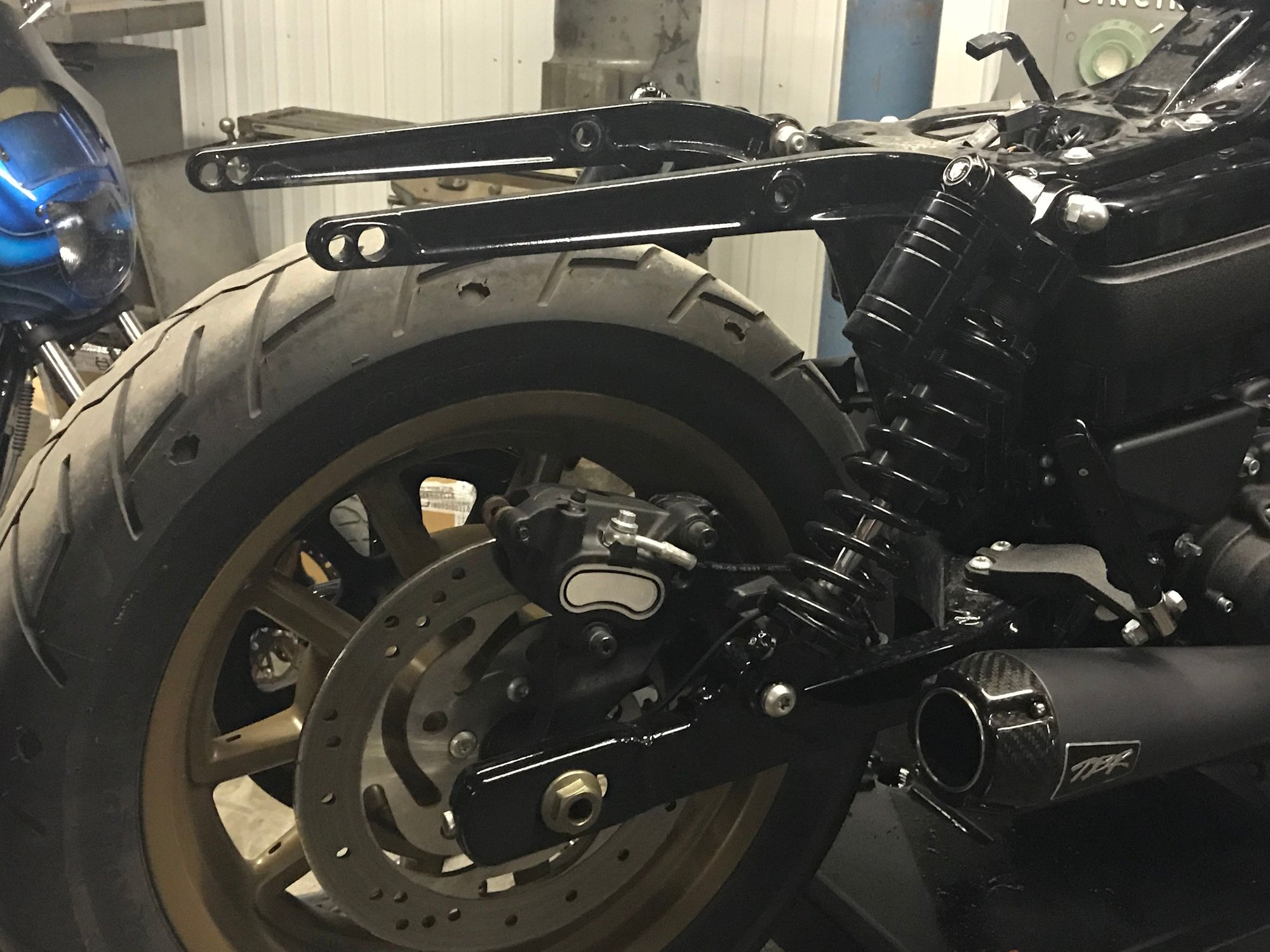

Here’s my plan.
13.5” ODC rear shocks, adjustable w/ reservoir
+2 ODC inverted front suspension, adjustable
Brembo radial mount calipers
Magnum Shielding brake lines (gives better brake application)
BMC The Wall seat
Will be replacing wheels with lighter ones wrapped in Pirelli Night Dragon tires
Will be replacing front rotors with 13.5” ones
Also different bars
This plus some engine work that’s being done and it should handle relatively well.
Current state:

Originally Posted by rbdub474
Here’s my plan.
BMC The Wall seat
Also different bars
Thats gonna be nice. What front end is it?, I see the ODC is that the brand?
