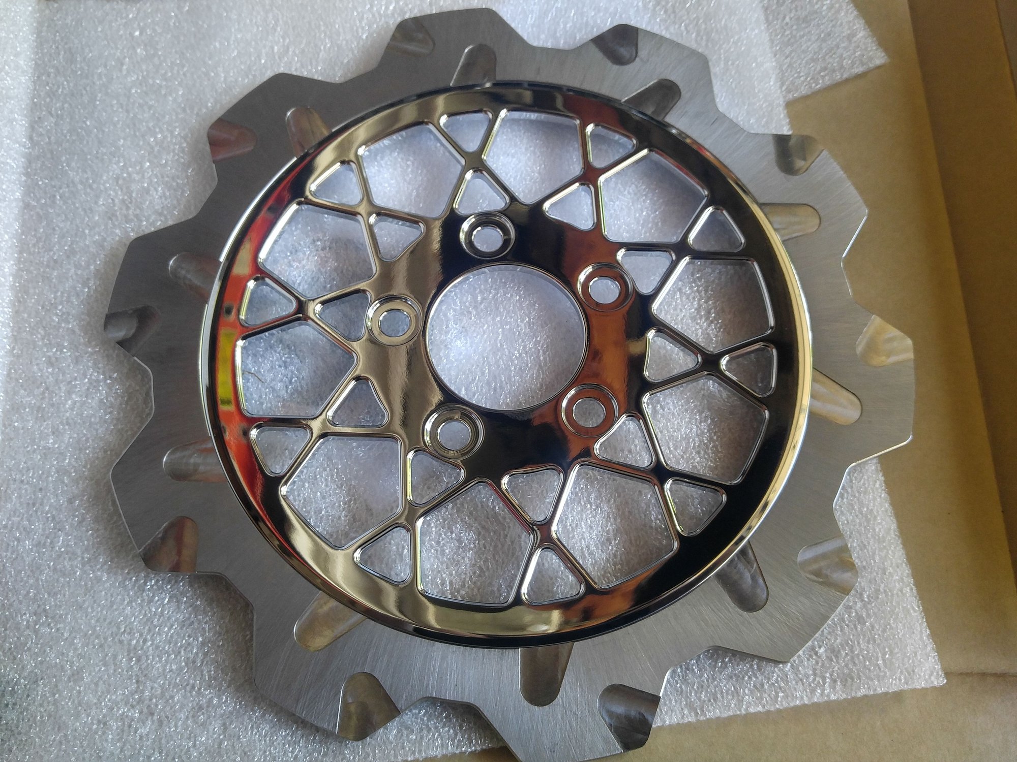

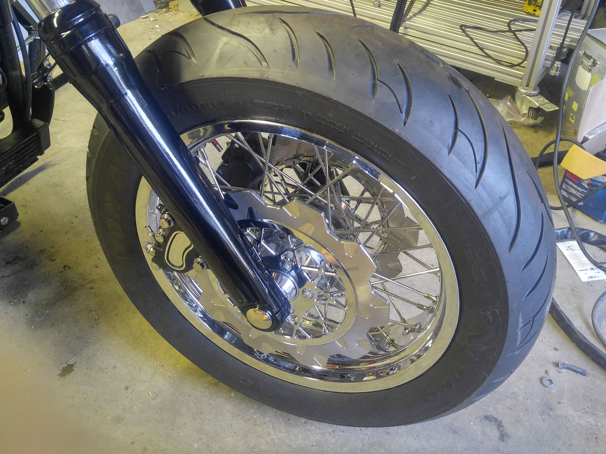

I ordered them directly thru Lyndall. They are the Gemini Crown Cut. They are two piece floating rotors but don't use buttons like most. There ia a big spirolox-type retaining ring on the back side and a dozen or so interlocking lugs machined in the two parts. There are several options for both friction ring and center. Style and finish. They do require use of Lyndall pads to retain the lifetime warranty, tho. I'd have to look at my notes, but IIRC they are around 3 pounds each...vs 5+ for OE floaters.
https://shop.lyndallbrakes.com/colle...nt=29811479761

Those lyndall are gorgeous and a pretty penny
I want a black carrier with the silver rotor with the six spoke design but I don’t see it on their website

Holy hell those are sexy!

I'm assuming the Lyndall "Indy" 6 split-spoke isn't what you want... You might consider Galfer or EBC. They both offer lightweight modular rotors.
I like the "airy" feel/look of the webbed center, especially on the busy rear end, and it jives well with the wheel spokes, I think.
