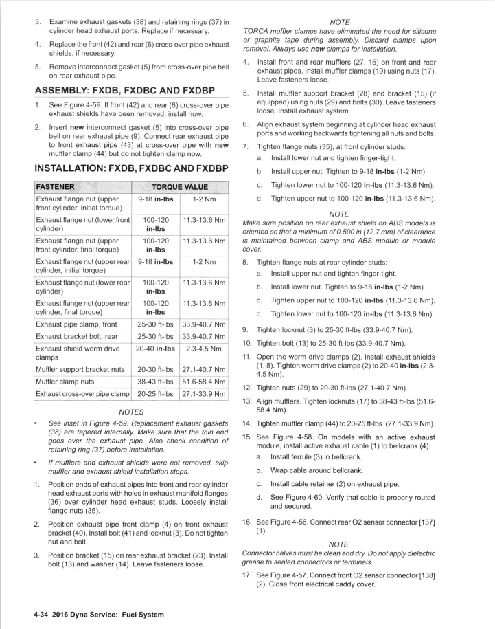

I will bet my last dollar, that the collars are not torqued to spec, I had many a vibration problem with mufflers, I went through all the bolts and torqued them proper, and vibration was gone, and if you played around with the heat shields, you will see the slightest variation in putting them back in the same place will cause vibrations, I have been there and got grey hair but finally got it sorted.

Didn't torque them at all. Didn't think I needed to. What torque specs did you use?

Hope this helps, and torque values are useful trust me.
