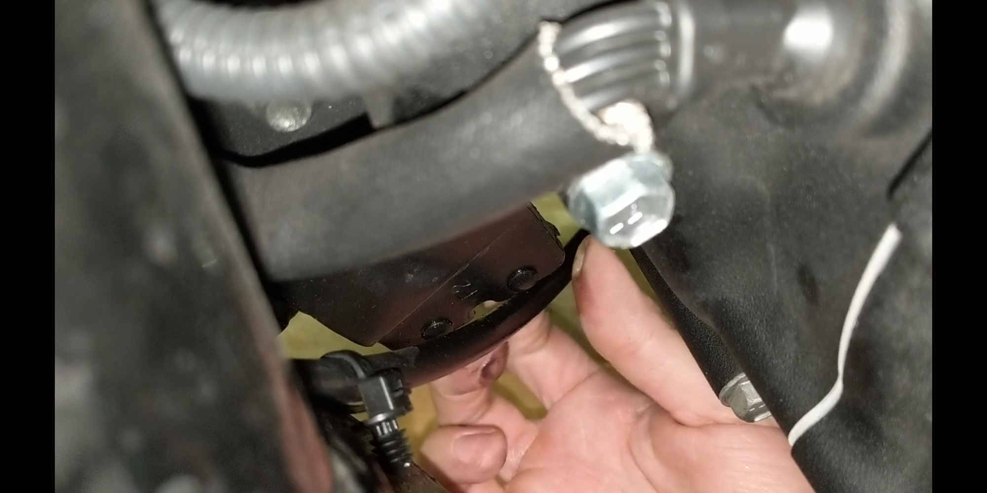

Installed new handle bars in my garage a few months ago, only cables that needed to be replace was Brake and Clutch. The dealer did those.
After 1k service I noticed a couple of oil drops, took it back to the shop and they cleaned it up, didn't see anything wrong.
Noticed the leak again, followed the trail and ended up noticing the drop forming on the clutch hose. I can feel a little dent with my finger.
I believe the cable is too tight and it was just a matter of time.
Had this happened to anyone? Is it safe to ride? It has leaked just a few drops.
It's been under a year since the dealer installed them, hopefully they'll take care of it.
I'm not even sure that cable is supposed to have oil. I'm working with very limited knowledge and skills here.

There is no fluid in your clutch cable. Look above the cable for your leak.

Dealer did the 1k service? It's contaminated engine oil drooling out from around the front isolator. When they pulled the old oil filter they saturated the isolator and didn't clean it up.
Try cleaning/degreasing the front isolator and see if the problem continues. Note, contaminated engine oil degrades the rubber of the isolator causing premature failure...

I don’t have a Dyna. Picture is hard for me to make out. Is that the motor mount? Is the cable lower than the motor mount? Does the cable leave the transmission and go lower than the transmission?
This is an old image of my Wide Glide, from back when I was silly enough to use OEM isolators; and that's the second isolator, the first failed very early on, 600 miles on the ODO. A Predator front mount and an oil filter relocation for the win on my Wide Glide
The clutch cable on the Dyna routes past and under the front isolator. JuanderBoy's front mount is oil saturated and the oil is weeping out and on to the clutch cable; a poor oil filter removal service. The front isolator will trap the contaminated oil and this will lead to the rubber degrading and the beginnings of the next dreaded 'dyna vibration' thread.

Thank you all for the help. It makes sense that the oil is coming from isolator. I cleaned the cable and the damage seems to be superficial. Besides, the oil is very dark.
The cable is very tight though, I'm going to the dealer and try to get them to fix that, hopefully with a new and longer cable.
