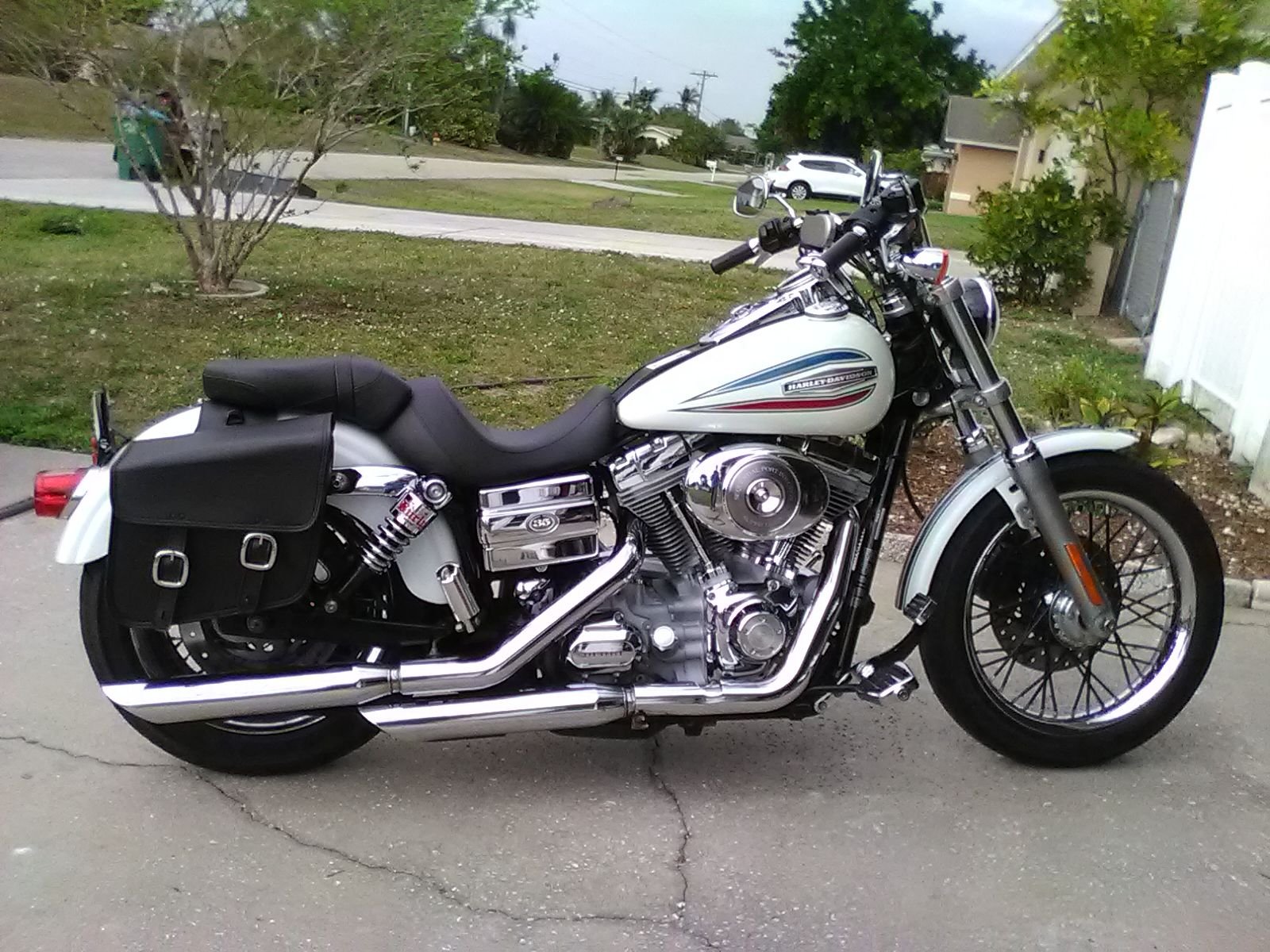

Have you had this bike from new on? There was a bracket that attached to the frame some where. There is no way the the Muffler clamps were designed to support them. If that was the case the header would break from the stress. What I have seen on bikes like my FB. Some one changes exhaust and leaves the frame mount parts off because it is easier.
It seems another frame bracket is missing.
Going to check the underside today. Bought the scoot from Dealer used as is. My mistake not going over the exhaust, never thought anything could be wrong there
Old Apr 8, 2018 | 11:19 AM
Tileman2692's Avatar
Tileman2692
Joined: Sep 2016
Posts: 1,636
Likes: 579
From: Cape Coral Fl

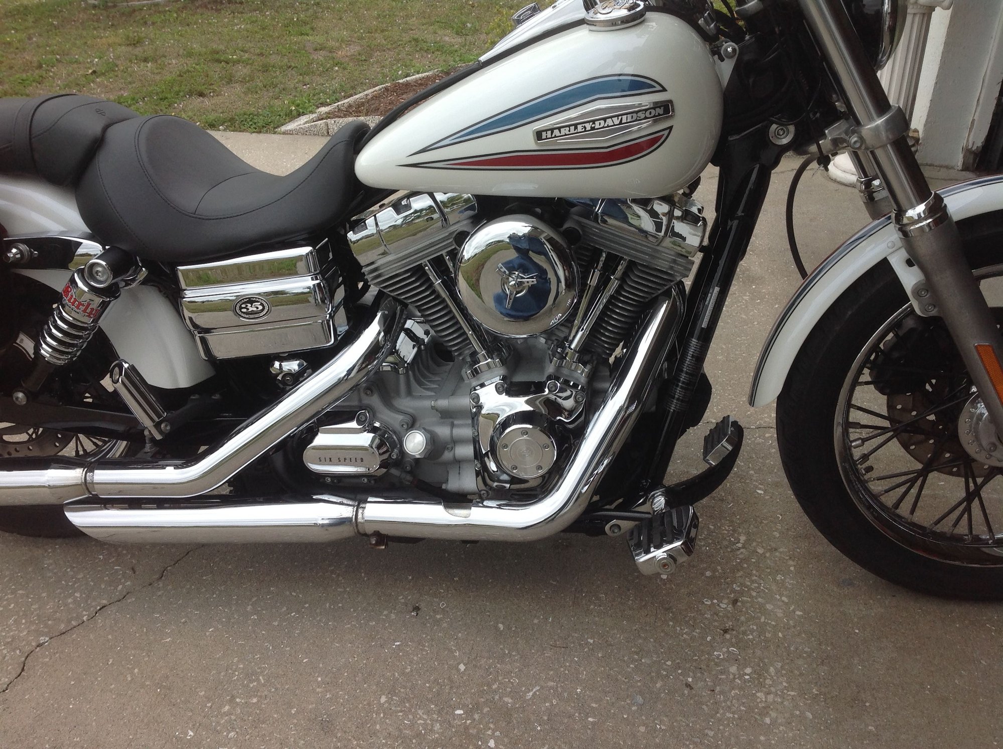

Well crawled under the bike, and no noticeable holes on the frame or the slip'ons.the header pipes are each bracket to the frame right at the slip on joint (end) but not on or to them. The pair of slip'ons are bracketed to each other the only thing holding the pair of slip'ons is the 2 clamps into the header pipes. If you look at the pic of my exhaust, right of the joint of the on the header side is where the h. Pipes are connected to the frame. All is really tight now and secured. If you ask me it's a bad disign.
Old Apr 8, 2018 | 11:23 AM
Tileman2692
Joined: Sep 2016
Posts: 1,636
Likes: 579
From: Cape Coral Fl
Now that I'm looking at more pics of my exhaust I'm noticing that the slip'ons are not all the way onto the header pipes,there's a good 1 1/2 inch space.....looks like they were not inserted all the way onto the h.pipe! Bingo! Someone....dealer or person who did work to the exhaust didn't install them correctly. Now there is no gap between the joints. Look closely see if you can see the difference
2nd to last is reinstalled
Old Apr 8, 2018 | 11:35 AM
Tileman2692
Joined: Sep 2016
Posts: 1,636
Likes: 579
From: Cape Coral Fl
Jeez how did I miss that!
